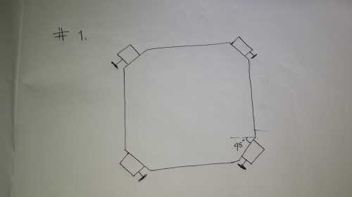

I am using a vectored thrusters setup with four thrusters as shown in the Fig and another two for vertical thrust.
So it may be necessary that the propellers produce nearly equal thrust forward and reverse.
Note (3).jpg (13.1 KiB) Viewed 4517 times
