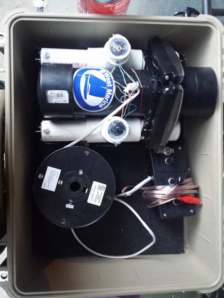

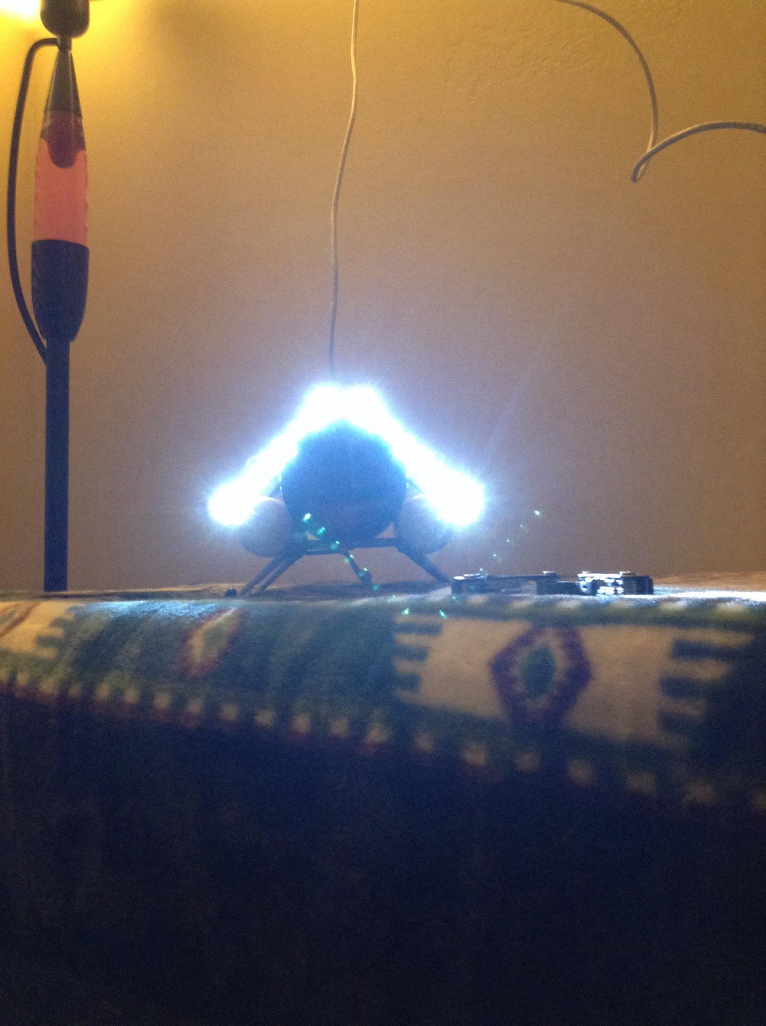

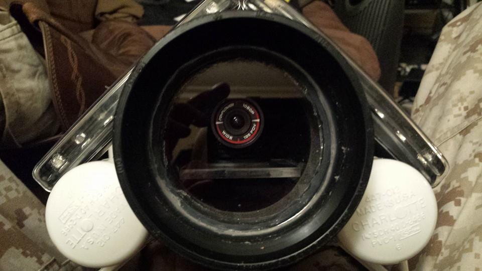

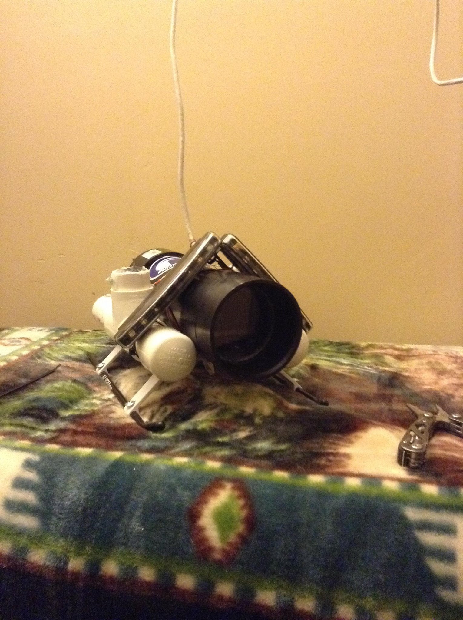

So this was my first attempt at building my own R.O.V. and so far this has been an awesome project.
parts i have used:
3" pvc pipe
1-1/2" pvc pipe
4 1000rpm electric motors fro Radio Shack
small project box (for the controller)
3- dual position toggle switches
2- el cheapo led fog lamps
100 foot CAT-5 cable
1- single position toggle for the lights
2- right turn props from Traxxas RC boats
2- left turn props also from Traxxas RC boats
a lot of silicon and electrical tape
i'm always open for any advice i can get for my next one i plan to build as soon as i can figure out the design for it !!
