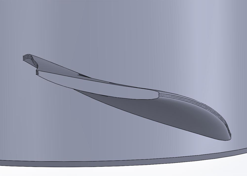

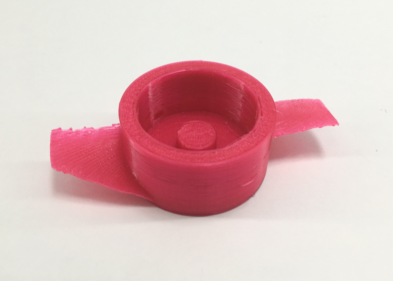

- T100Bilge-011.jpg (914.8 KiB) Viewed 65504 times

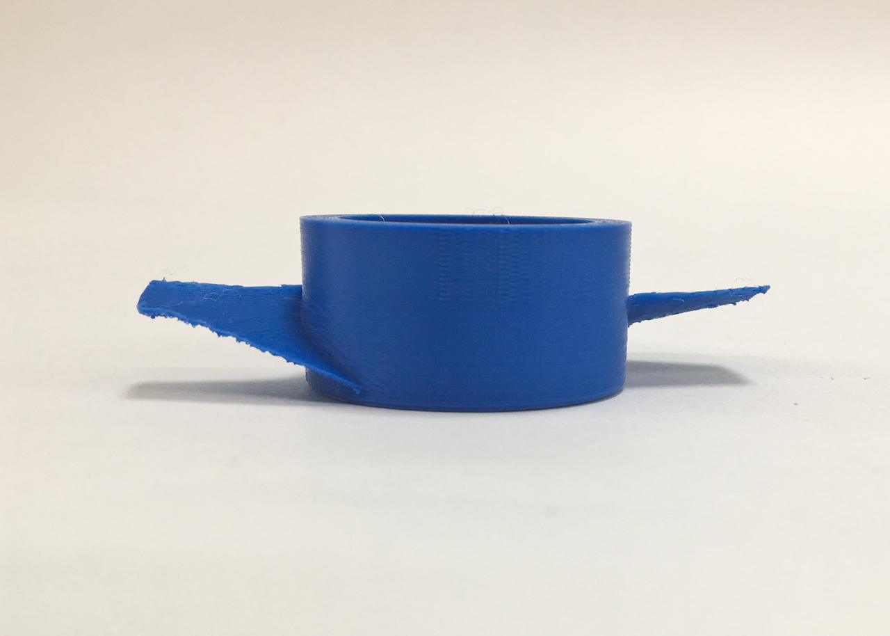

I gave the prop a try with the same crappy filament and ran into some issues. (I had a feeling printing this would not that easy or straight forward becuase of the angles of the blades)
- T100Bilge-012.jpg (507.82 KiB) Viewed 65504 times

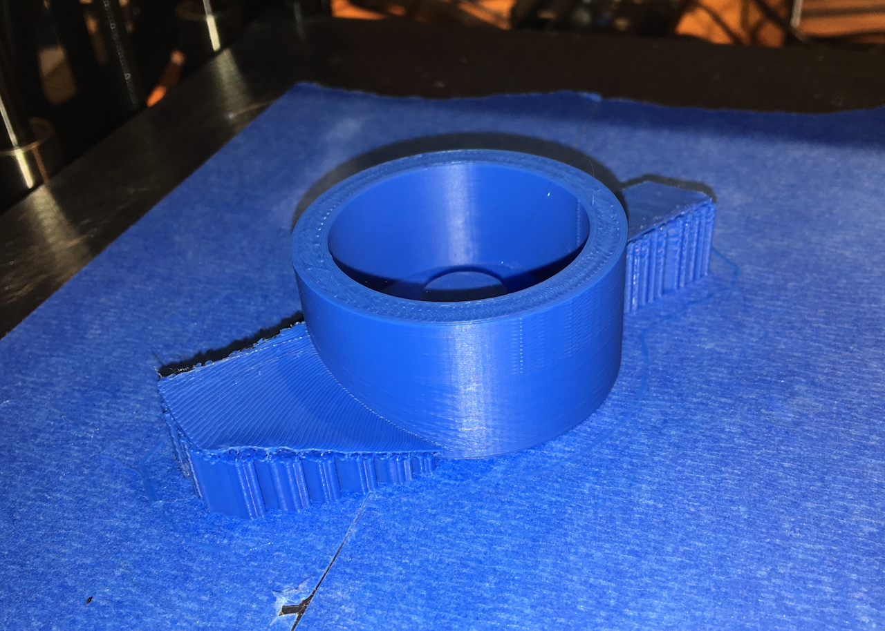

The blades are so thin that the edges are tending to warp when printed in PLA. (Things would probably be a lot easier with a duel nozzle printer that could print with water soluble supports.)
- T100Bilge-013.jpg (474.45 KiB) Viewed 65504 times
I could probably heat the edges up and bend them back to the correct positions if I wanted to but I thought I'd try a different material. (PLA isn't the best choice for outside items anyway.)

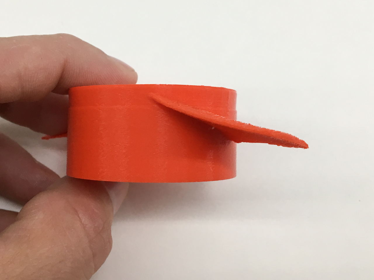

- T100Bilge-014.jpg (496.58 KiB) Viewed 65504 times

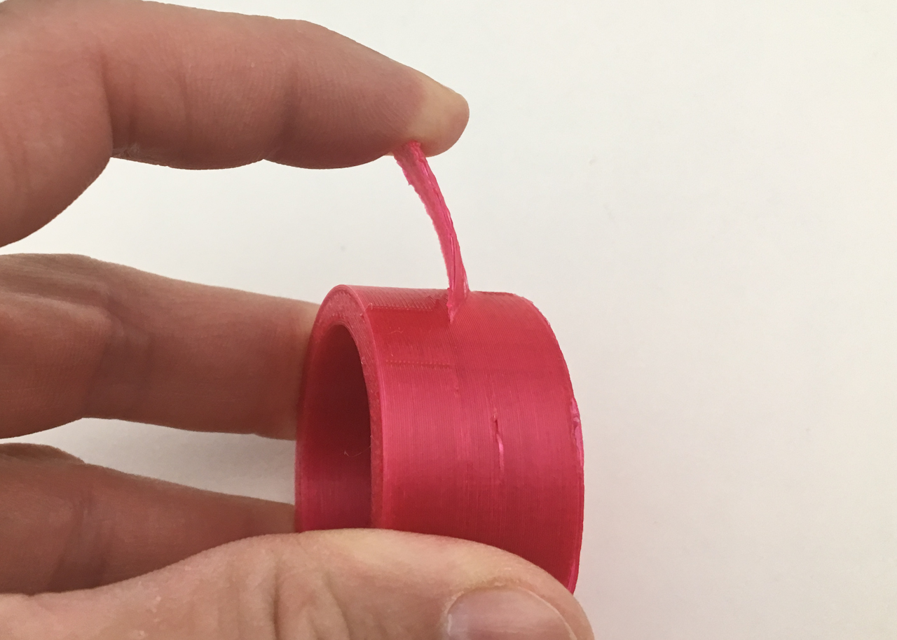

I next tried to print a prop in PETG and while it came out a lot better....
- T100Bilge-015.jpg (531.58 KiB) Viewed 65504 times
... the blades are way too flexible.

At this point I decided to make the blades thicker and see if that would help with the printing. I really don't have the CAD skills to redesign the angles on these blades so for now I basically just stacked several copies of them to make them thicker. The weird edge details will be ignored by the slicing software because they are so thin.

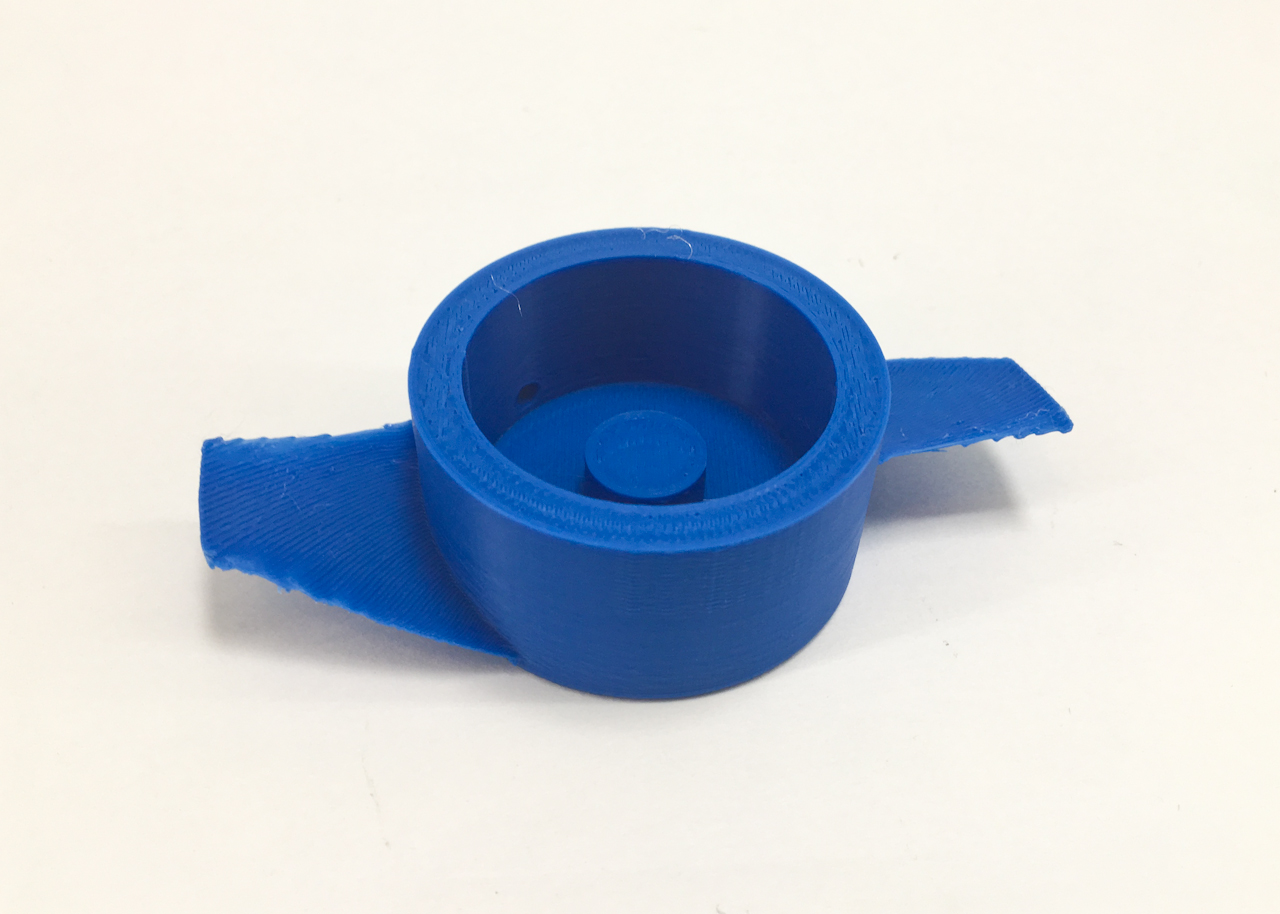

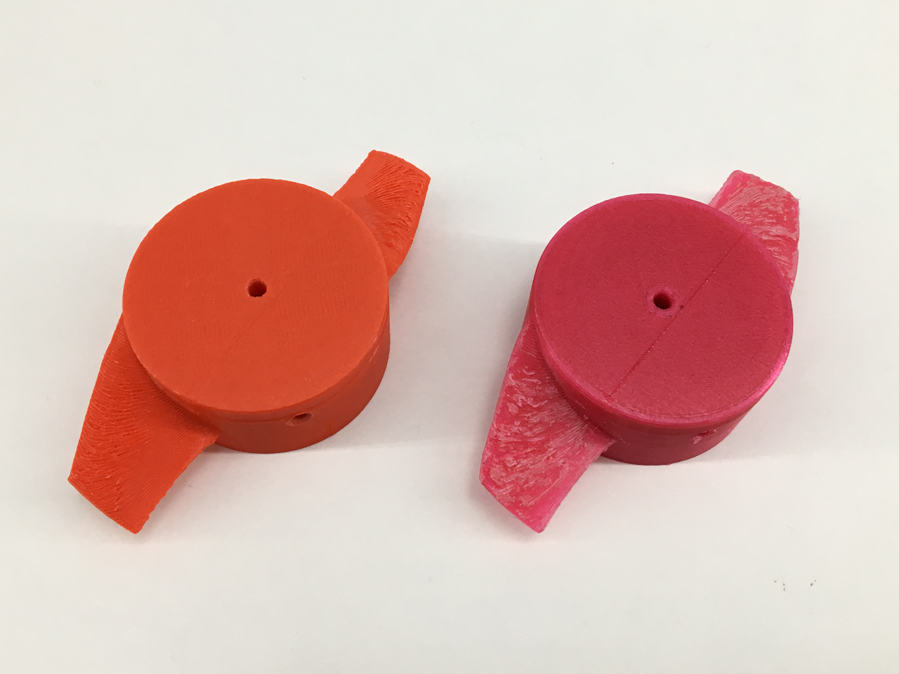

- T100Bilge-018.jpg (551.63 KiB) Viewed 65504 times
I printed this thicker version in both PLA and PETG and they came out a lot better. (In these pictures I rough sanded the PETG one but not the PLA one yet.)
- T100Bilge-017.jpg (524.13 KiB) Viewed 65504 times

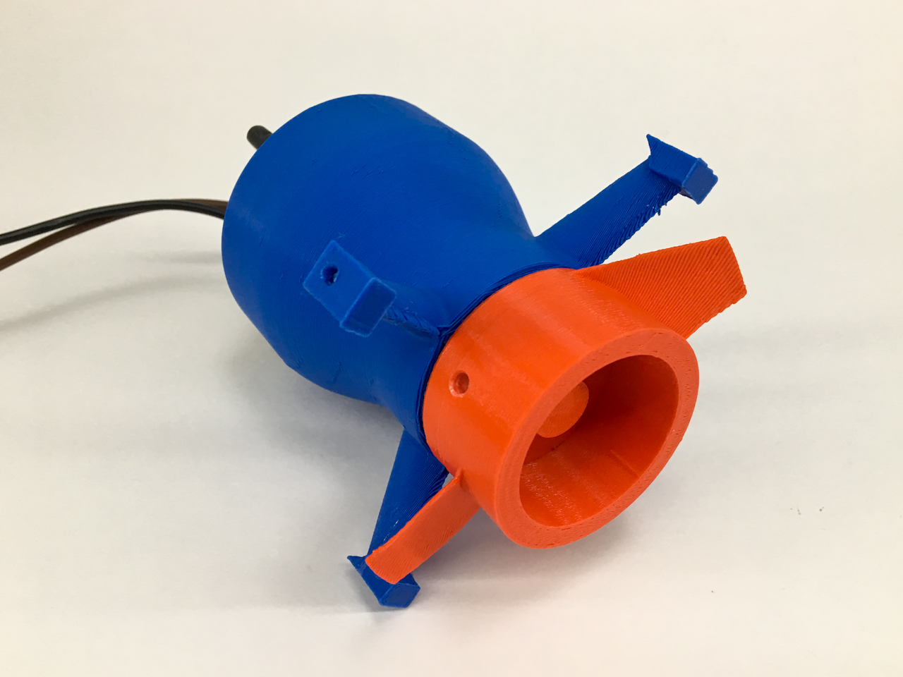

I don't know if it will affect the thrust out put of the prop but it definitely came out better being thicker.
The PETG one is still a bit flexible so I'm going to test it first with the PLA version.
- T100Bilge-019.jpg (627.63 KiB) Viewed 65504 times
Next it's on to printing the nozzle which might present some challenges but I think I know how to get around them..... We'll see.
