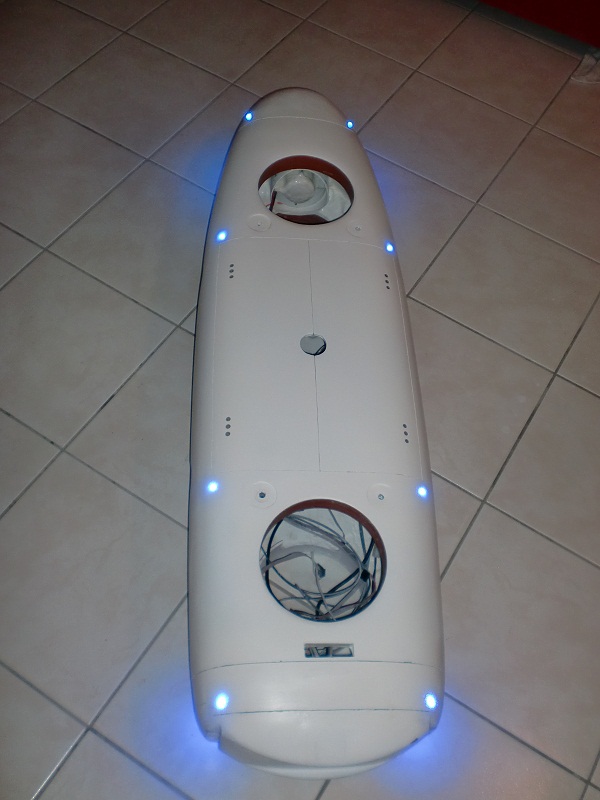

Hello guys,
this is my new ROVER3D (without thruster an electric). I think the first test starts in 2013.
Please dont ask me about the costs :oops:
I use the new ROV-Control unit, avalible in Spring 2013. More infos here in the next weeks.
You can also visit my ROV-Forum on http://www.r-o-v.net
Some Infos about the ROV: (sorry in german)
Camera:
3x Gopro HD 1080p (Front 3D (2), Boden(1))
1x Türspion-Kamera (Heck)
3x 32GB SDHC Class 10
Thruster:
7x Robbe BL-Control 930
4x Robbe Roxxy BL 2827/34
2x Robbe Roxxy BL 3545/12
1x Modellcraft BO223
Accu/Current:
8x Turnigy Lipoly 4S5A 25C 5000Ah
1x Robbe 6-Zellen Equalizer
7x ACS715 30A
4x ACS712 5A
Light:
11x Led-Slave V2.2 KSQ 1000mA
25x Cree XM-L T6 Emitter
1x 7W COB
16x 0,5W LED
4x 100mA KSQ
Sensors:
2x HMC 5883L Kompass Modul
2x 6DOF Lage/Beschleunigungsmodul
1x SHT25 Feuchte/Temperatursensor
5x TMP175 Digitaler Temperatursensor
1x Venus GPS Modul
1x Bluetooth Mate Gold
1x Endress&Hauser 6Bar Drucksensor 4-20mA
Electronic components:
2x I2C-Level Shifter
1x Polulu Step Down Wandler
Transmitter:
1x Fiber-Optic Transmitter 2xVideo, 1xRS232, 4km
Pumps:
1x Bilge Pumpe 6800GAL
1x Minipumpe 12V

thx for your compliments 8-)
for body i use 10 layers of glass fibre and epoxy resin. For modelling i use epoxy resin with micro-glassballons.
The fiberoptic is a standard cable. i've searched for neutral bouyant cable but found nothing payable. So i have installed balls of epoxy resin and glassballons to neutral cable bouyancy too.
For videocontrol i will test a new 3D-solution with 3D-videoglasses and real-3d videostreaming
Rover3D ist my second ROV. in 2010 i was with my first ROV (ROVERII) for a documentation film about sunfish(mola) at Elba(Italy). ROVER1 was only prototyp.
Sorry for my bad english... school is a long time ago ;-)
