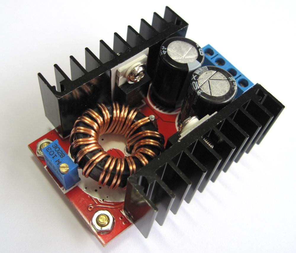

I had to buy a DC to DC step up transformer to drive them off my 11.1 Lipo on board batteries.
http://www.ebay.com/itm/150W-DC-DC-10-3 ... 416b154e17
- l_iUDA150w-dc-10-32v-to-dc-12-35v-adjustable-step-up-boost-po.jpg (80.6 KiB) Viewed 48640 times

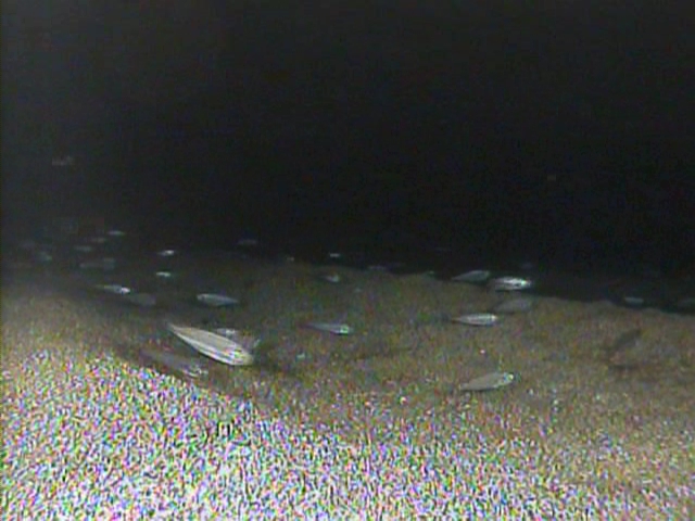

Hi Amarillo_rocket,
I'm also quite new in ROVs, yet I had some recent experience with LED lights.
In my first ROV I had two small 12V LED lights (not even sure about their Watts) which I tried in night dives.
I was impressed of how nice my camera showed (see snaphshots).
In my new ROV I have made 3 new 12V LED lights but three times bigger than the old ones sealed by embedding them in transparent resin. I have not tested them yet. The new lights are cheap (approx. 8 Euros or 12$) and the resin also costs about another 12$.
Yet, my cameras have a very high light sensitivity (less than 0.5Lux) as I want to get videos even during night or at depths higher than 30m.
On the other hand, no matter how much light (or what type of lights) you are planning to use, you will have problems with the algae or and/or floating particles. I have only tested my ROV in clear waters, but from scuba diving experience, I can tell that if the water in the ponds has a lot of algae then adding light probably will make things worse due to refraction. Anyway, you have to try to see the light and visibility conditions close to the bottom.

- Small fish close to sandy bottom at 20m depth (night dive)
- Triton_night_snapshot2.jpg (190.27 KiB) Viewed 48618 times
