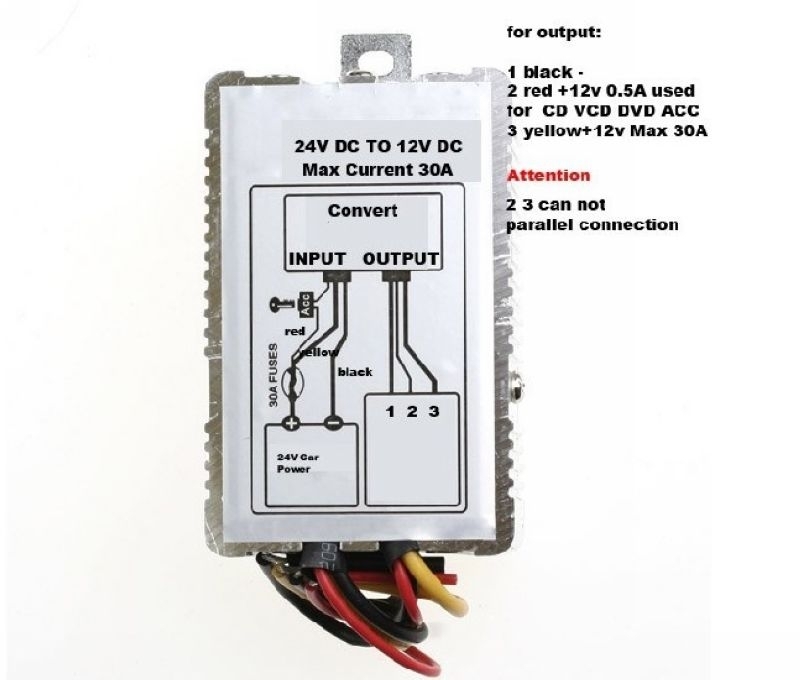

Yes you will have a voltage drop in your tether, but starting with 24 volts will cut the loss in half if you use a 24 volt to 12 volt DC to DC converter..... They use them on Semi's to run 12 volt appliances off of the 24 voltbattery system
I purchased our DC to DC conveter on eBay for approx 14 dollars...... looks like the photo below.
NOTE: although they rate it at 30 amps, it runs cooler in the 7 to 10 amp range with occasional higher bursts of current draw.
During our testing, I was pounding the power through it, adding additional load, pushing it harder then I typically would to see if it would take it, and it did get hot enough that it powered down until it cooled enough and came back on line 30 seconds later.
If you are going to consume 10 amps at the ROV, our testing has show that you will be drawing a little over 5 amps through the tether @ 24 volts.
Using a 110 foot tether at 24 DC with a 5 amp load on it, you will have a 2.75 volt loss, and should have 21.75 volts at the dc to dc convertor. Since it drops the voltage in half, you will have approx 10.8 vollts available to the ROV motors pulling 10 amps.
The actual voltage drop will vary depending on actual motor load.

- 24 volt to 12 volt DC to DC convertor. 30 amp max.
- 24v to 12v.jpg (106.78 KiB) Viewed 9926 times

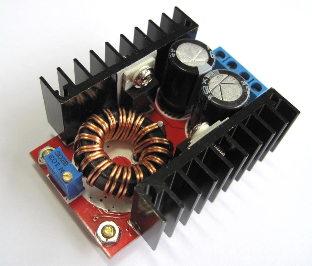

There is also another style DC to Dc converter (step up module) that I use. It has a completely adjustable/setable output voltage. I needed 30VDC for my LED lighting. I connected two 12V batteries in series actually 11.9V and 10.8V when I measured them. I adjusted the output to 30VDC. Later I connected the converter to a single 12V battery and the output remained constant at the 30VDC that I had it set to earlier. It can handle 10 amps

Where did you find the adjustable step up converter???
I want one!!!

Hey Ian,Ian MacKenzie wrote:Where did you find the adjustable step up converter???
I got mine off of Ebay.
Here is the link I posted a while back... might be able to dig a bit and find this on a ebay.com (vs .ca)
http://www.ebay.ca/sch/sis.html?_nkw=2x ... 1163929926
