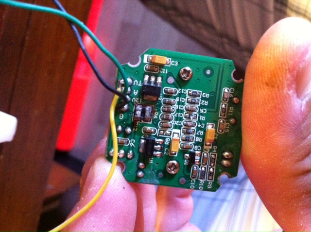

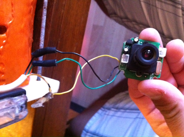

Pictures....

Are you sure your connections inside the shrink wrap are good? Are you sure the camera is rated for 12v. It sounds like either your connections are bad or the camera is fried. From looking at your pics, everything is connected correctly, so it has to be either a bad splice or fried camera from to much voltage
