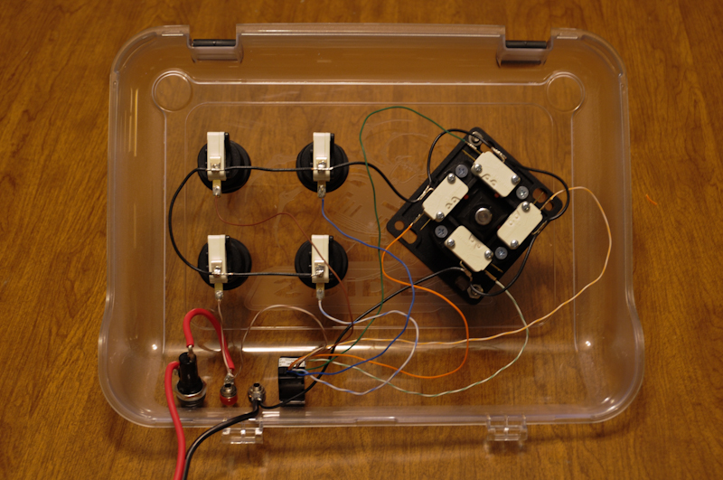

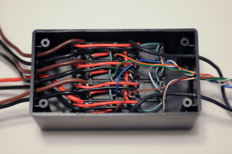

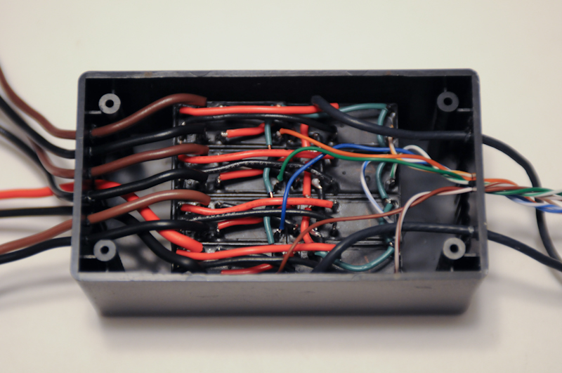

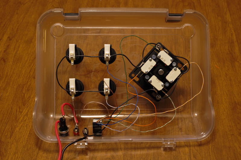

Sorry for the delay, but here are some real life pictures of my relay setup, these are before the sealing process.
This setup shown is using 2 Duel Post Duel Throw Relays for each function. I used 8 in this setup 6 are for Forward/Reverse Left/Right Up/Down with the last to for options. (I.E. = open close manipulators) Everything is pretty compact in this setup because it is going in a small Rov with a 10" footprint, but should get the point across on what it should look like.
This is a view of the bottom of my control box, It uses a simple Arcade type joystick, 4 arcade buttons, a cat5 jack and banana plugs for the tether connection, and there is also a fuse holder too.
