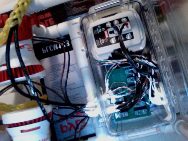

- rov 90% assembled letting the 5200 glue dry
- Photo on 2011-09-14 at 23.51 #2.jpg (101.72 KiB) Viewed 9496 times
- inside relays and Ryobi 12v battery
- Photo on 2011-09-14 at 23.52.jpg (120.51 KiB) Viewed 9496 times
- control case
- Photo on 2011-09-14 at 23.52 #2.jpg (92.84 KiB) Viewed 9496 times

I see that you have onboard battery. What type and how big are they (AH)? planning to use the same, but I have problems to figure out what type of battery to use.
Re: almost finished .....
There from the Ryobi HP612K 3/8 in. 12-Volt Cordless Drill/Driver Kit there 3.75 x 3 x 3 inches is the total foot print( as if it was a cube )
