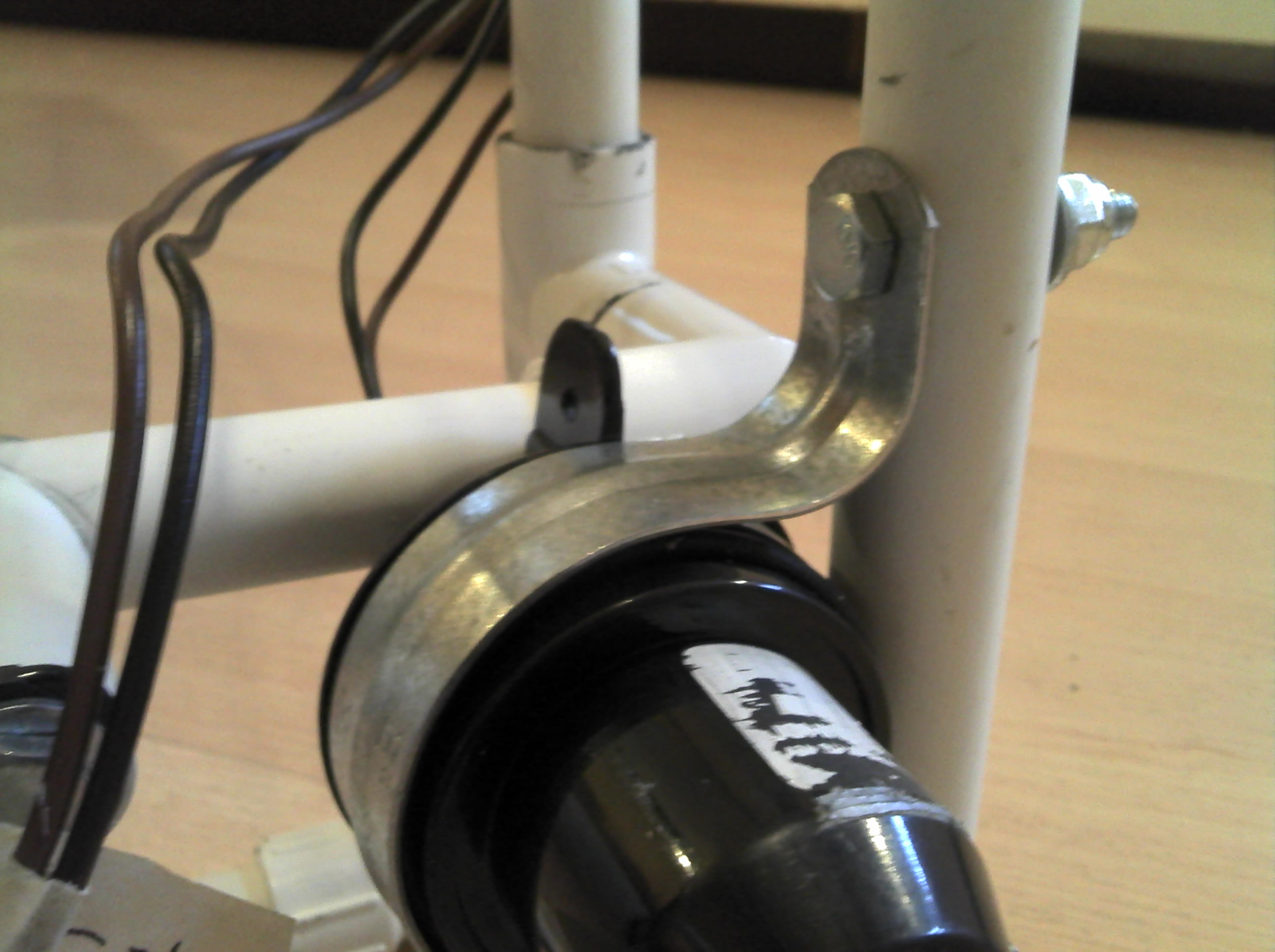

Mounts for the motors has always been my biggest problem. Luckily, I found these 2" pipe straps at the plumbing store. They fit perfectly on the 500 GPH motor cartridges. I recommend these if you are needing a way to mount them
- This is one of my horizontal motors on my scout class ROV for the MATE competition

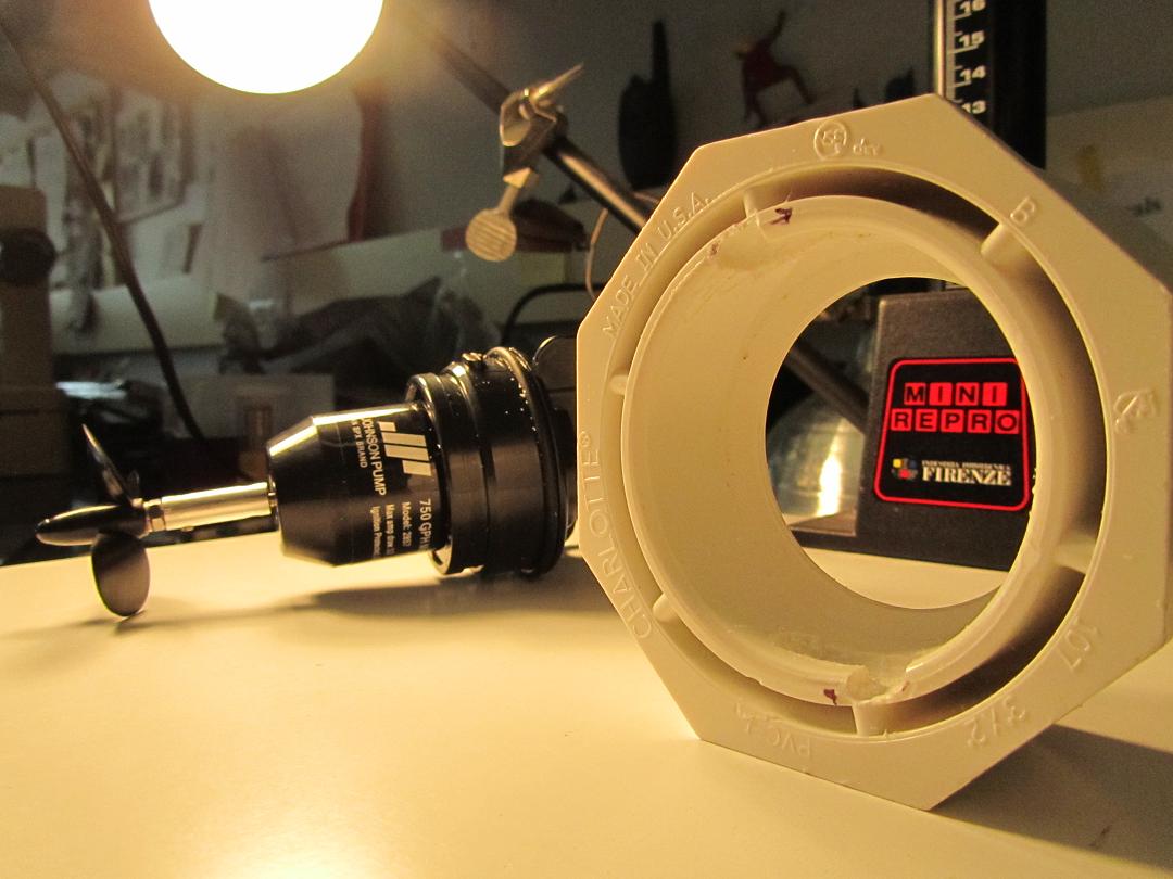

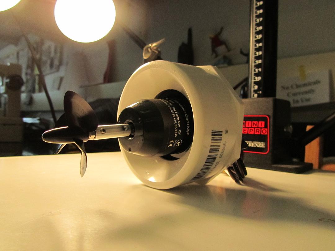

I went with Harbor Models for the props and Tower Hobbies for the mounting coupler. Used a cut, 4mm screw and seems to work like a charm (i still have to test). I also found a perfect piece of pvc and use a dremmel to carve out grooves for a slide and lock (locking tabs were already present on the bilge cartridge). It fits nice and snug
