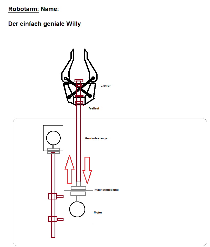

have a look at that one, its cheap and works Just the magnetic couplings are a bit of an investment

You were mentioning some watertight servos.. Have you got any link to it? I was looking a long time for them but no one was suitable to go 100-200 meters. By now all of my housings are approved to 60 bar, only my fiber optic tether can not go deeper as 200m, but anyway, I have to find first a spot that is deeper than 80m here in the Siam Bay.. :lol:
The design of my arm is now planned with magnetic couplings, not the cheapest solution but the safest..

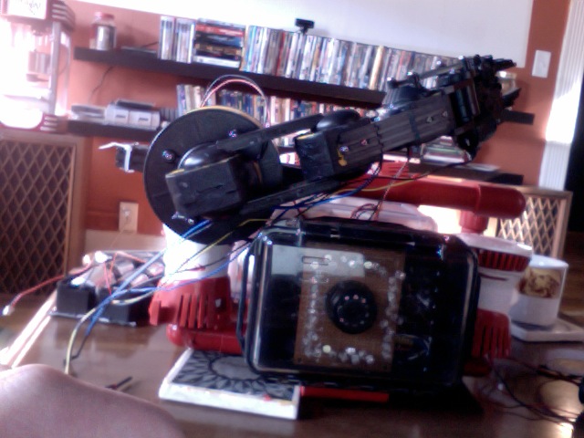

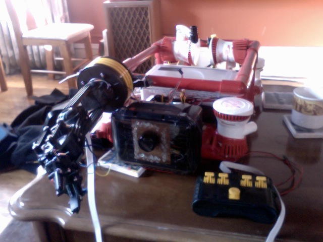

this is my arm
Photo on 2012-01-04 at 12.06.jpg (99.39 KiB) Viewed 17565 times
Photo on 2012-01-04 at 12.07.jpg (89.79 KiB) Viewed 17565 times
