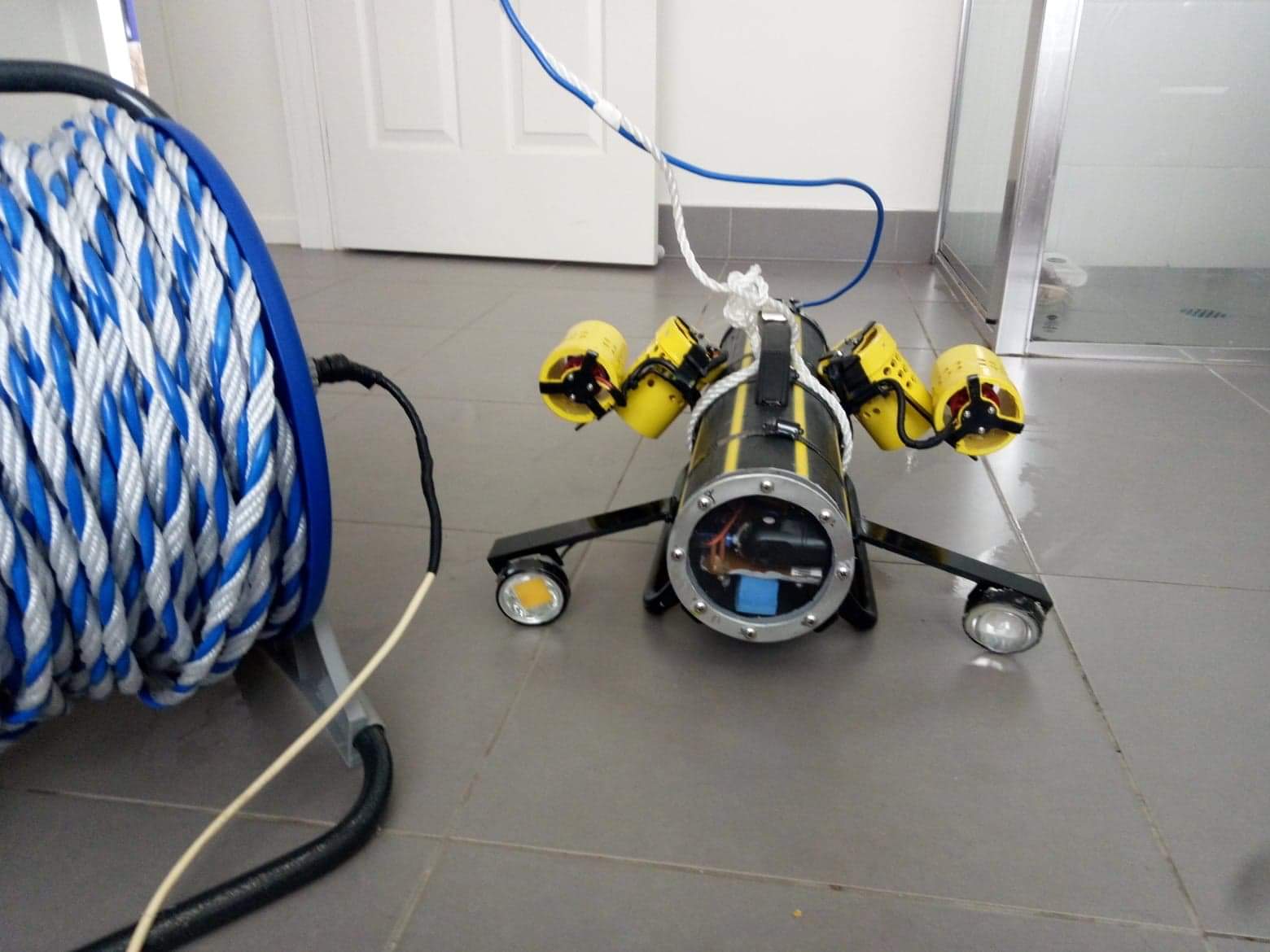

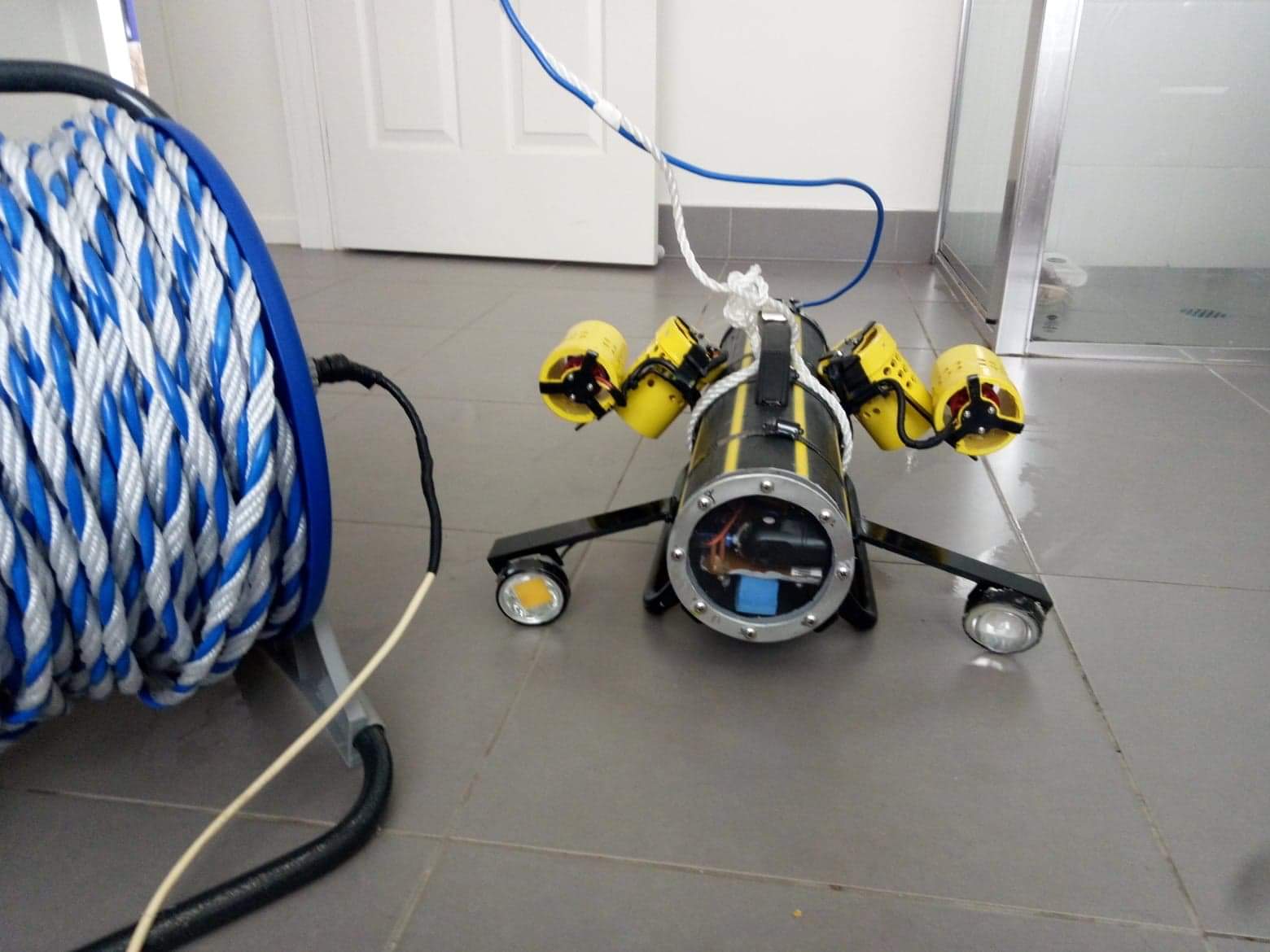

Well here's what I've done since my first post above. I mashed together this contraption I call the ROV Nudibranch. It's still in it's testing phase but I should have some photos and videos posted in other topics soon.
Empty housing tested to 48m

It is Cat6 cable wound into 7mm polypropylene rope, as the poly rope is buoyant it counteracts the weight of the cat6. Seems to work ok in the pool with about 10-15m wound out but not sure how it will go once I have a lot more wound out. There is a 100m of it and it also provides a bit of strength in the tether if I have to drag the ROV back in.
