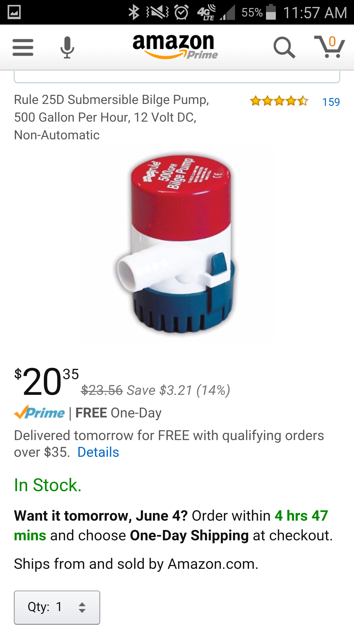

Hi new to forum. been looking thru threads for days but still need some help. building first rov. have the rule 25d bilge pumps 500 gal. per hr. what props and prop adapter should i get ?
any direct part numbers or links ?

3 rule 25d bilge pumps

I found the Robbe 3 Blade 50mm prop to be the best suited for most of the bilge pumps I've tested. I custom make my own adapters but if you don't have that ability I believe someone just posted some they bought recently that worked well. I don't remember who posted it but try searching the forum and you should fine it.
