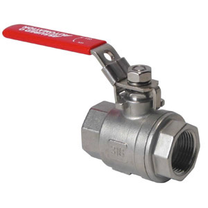

3. Buy a ball valve or similar that can handle 450 psi and manually open it when out of water. A concern could be that I forget to open it. A advantage is that there will be a hole straight into the compartment so pressure building up would escape immediately. No tools required and no flying projectiles, might get a bit bulky and perhaps cause a jet of flames shooting out if the batteries ignite.

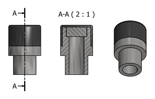

4. Make my own pressure release system that can handle the pressure. I was thinking a bit how the design would look and thought about the base principle. It need to brake easily when force is applied from the inside and withstand force from the outside. I made a simple design to get the thoughts going realizing that it could turn into a bullet if an explosion would to occur.
