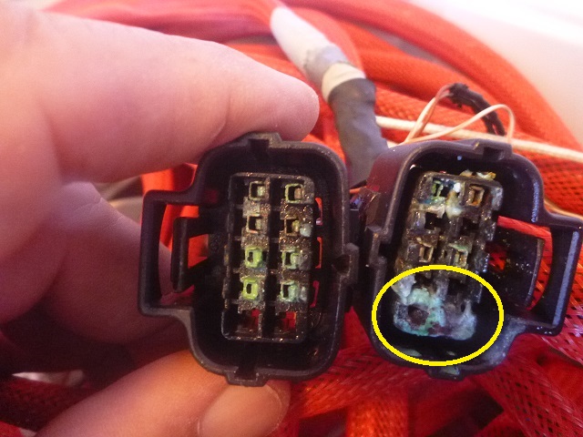

Unplug the connectors (disconnects?) and see if there is any green colour on the pins. In saltwater, corrosion/electrolysis of this sort happens almost instantly. Would create a high resistance, stopping the motor.

Yes there is green on the connectors. The yellow circle is the 24v power cables. But if the corrosion is causing the drop in voltage why does the voltage return once it is out of the saltwater? The more important question is how do I prevent whatever the problem is? Would it be enough to space the power cables further apart?

The contacts are close enough so that the electricity jumps between the positive and negative contacts when they get wet. This is what is causing the corrosion. This shorts the circuit before the power reaches the motors and limits the flow of current to them. When you take it out of the water, the contact dries out and a short circuit is no longer made, hence the power returns to the motors.
Moving them further away from each other should help. Or waterproofing them completely.
