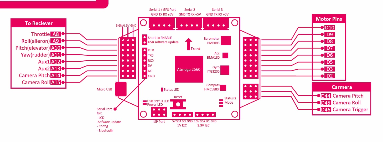

They are designed to control planes and Multicopters, but basically they are a PCB that will accept Arduino code. All of the Multiwii stuff is written in C++ and can be edited etc in the Arduino GIU, but you do not have to use their code for your ROV, it wouldn't work, you can use your own code though. The board I am using now is the one shown in the following diagrahm, it has a compass
amongst other bits and pieces. This board would cost about $40, hobby king sell it, but I think it comes only as a bundled package with a gps for $70. There are cheaper boards that use 328 chips instead of the mega, but most of them need a FTDI to use for programing.
The 328 chip is used on many of the Arduino boards such as the Promini, nano, leonardo etc. The promini needs an FTDI too if you decide to use one of them.
The only reason I suggest it is that to me it seems the cheapest way to get all the bits and pieces and have them in a neat package, when it's all over you can throw the Multiwii code on the board and build a quad copter, or whatever.
