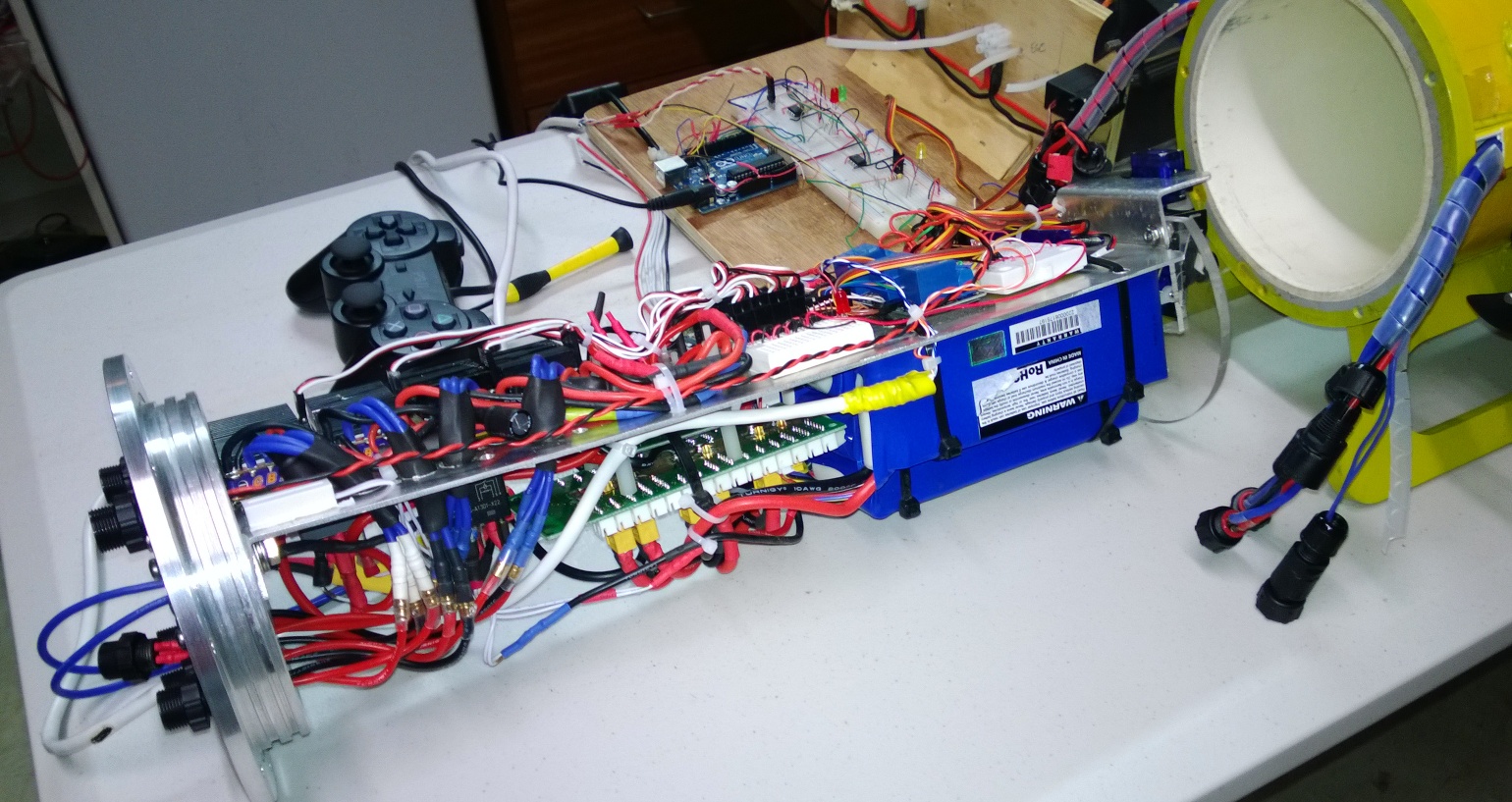

They are in in two halves and each half has several components.
After soldering all my wires in I still potted the rear portion of the connector just to keep all water out of there. If you do that make sure you tape off the rest of the entire connector in case there is any spillage of your resin.
I mounted half of mine directly into my rear bulkhead ( a m12 x 1.0 tap is required, they are rare). I also potted this on the inside, again just for good measure.
This photo shows them in various states of fitting, I didn't align the tap very well when tapping the holes. :oops:
This WEB SITE sells a slightly larger (M14) version and also as a panel mount fitting, I think I will buy these next time. There are also 22mm versions available.
I use
4x 3pin (one for each motor)
1x 2pin for the leds, i will use 3 pins next time just to standardise
and 1x 6pin with the blue collar for my tether.
The reason I use so many is so that if I need to replace a motor it's easy this way.
The main difference between the blue collar and black collar ones is the way the conductors are mounted. On the black ones the conductors are potted on the blue ones they are loose and would allow water through, and even epoxy , if using the slow setting variety.

Wow impressive ROV!! :shock:
And thanks a lot these should be perfect for mine!
