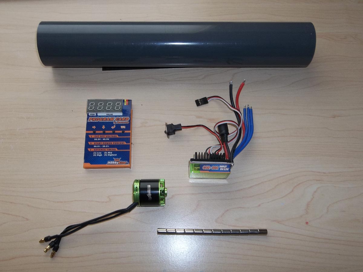

These are the parts I have purchased all ready. The housing and rotor parts will be turned from a solid piece of 2" PVC Rod. I choose PVC because it is cheap and easy to machine. The motor is a Brushless Turnigy Multistar 2216-800Kv 14Pole Multi-Rotor Outrunner and I am using a HobbyKing Brushless 30A Car Electronic Speed Controller w/ Reverser for control. Not knowing much about Brushless motors and controllers yet I bought a Hobby King Programming Card too just encase it needs reprogramming. The Magnets are 1/4" x 3/8" Neodymium Magnets.

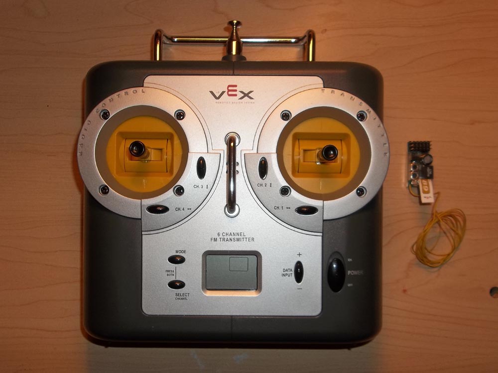

I've never used brushless motors before so I want to make sure I'm not going to burn anything up before I machine up the housings. I bought a few of these Vex controllers years ago that should be perfect for testing out the new controllers.

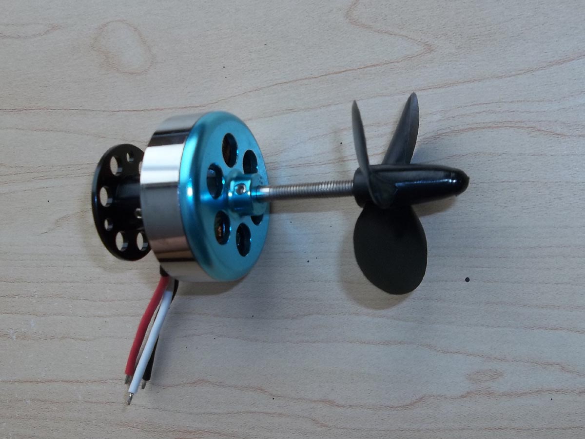

I also bought one of these hexTronik DT700 Brushless Outrunner 700kv motors because it all ready has a 4mm shaft. I want to test out running a brushless exposed to the water and this one should be the easiest to do that with because I can just trim down the shaft and screw on one of the many 4mm thread props I all ready have. (this is a thread for another day though)

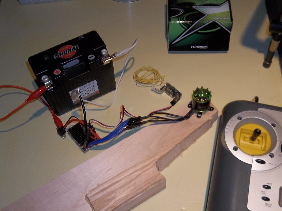

I did a quick test setup today just to try out the motor. I'm definitely going to have to use that program card because it needs to complete stop and I need to release the stick before going in reverse. I think this has something to do with a brake feature. It also is not as powerful in reverse as forward either. Hopefully it's something I can program into the ESC I really haven't looked into the card yet.

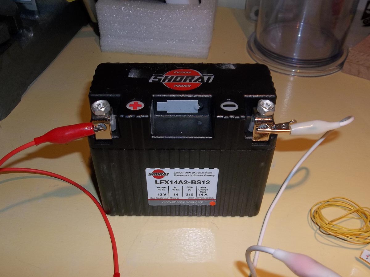

On a side note I took this out of my motorcycle for testing purposes but this might be a cool little battery to use as on board power. It's made by Shorai and they call them Lithium-Iron batteries, this one is 14Ah and has 210 CCA (not really important here) but is only about 4 3/8" L x 2 1/4" W x 3 1/2" H and the amazing part is it only weights 1.5 lbs (which is super light compared to a lead-acid battery) It's a little big to fit in a 4" PVC pipe but I night have to make a housing for it and give it a shot.

The Lithium-Iron batteries are not cheap: http://www.batterymart.com/p-shorai-lfx ... ttery.html This may not be the cheapest place to buy them. The chargers are not cheap either: http://www.batterymart.com/p-sho-bms01- ... arger.html However I think that the universal battery chargers used for charging LiPos/NMHi batteries may charge these kinds of batteries.
The specs say that they do not produce an explosive gas during charging which is a plus.
They are extremely light compared to a SLA, but could be used as ballast to eliminate the power cable in the tether.
TCIII/SSN626B

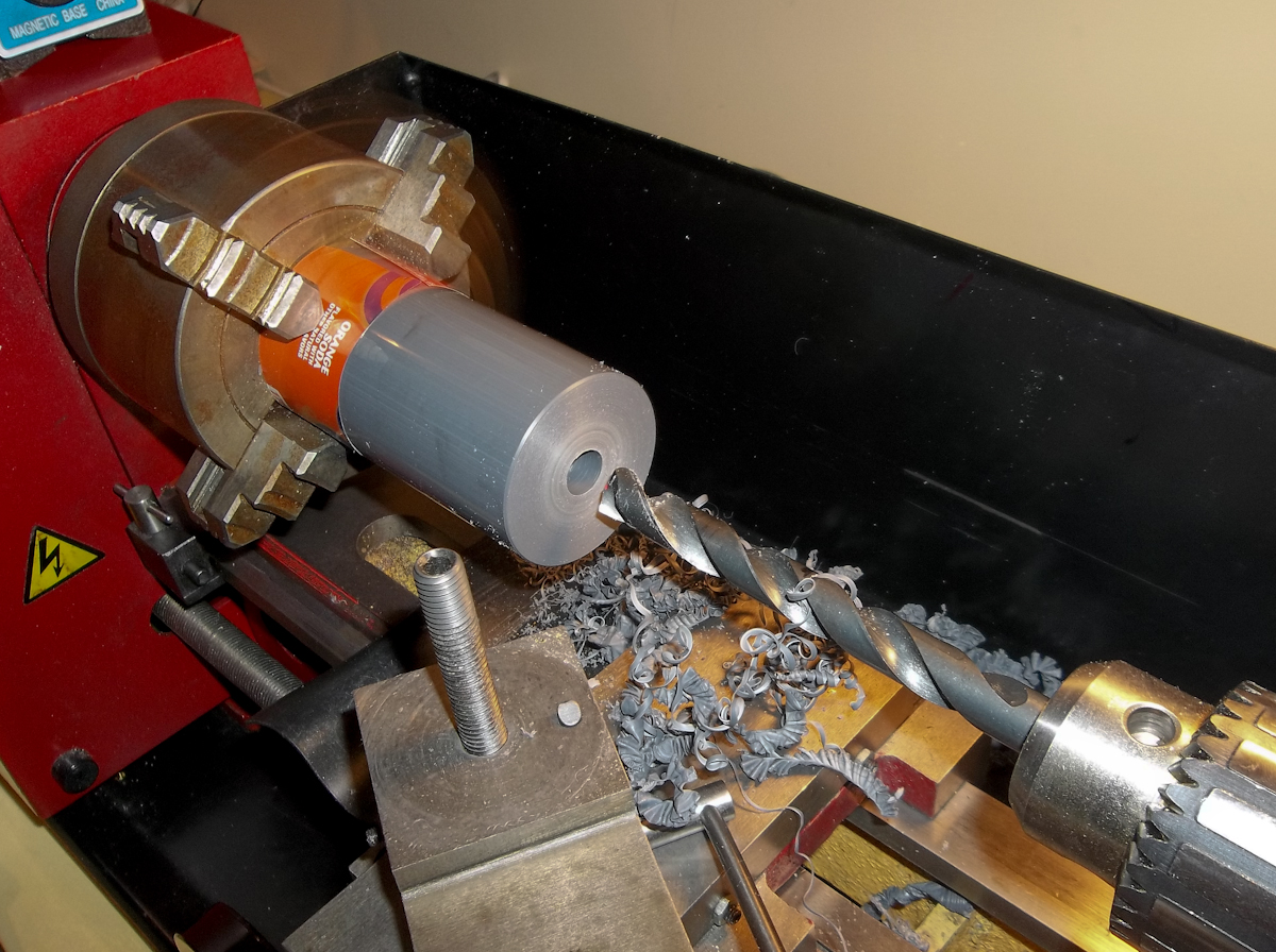

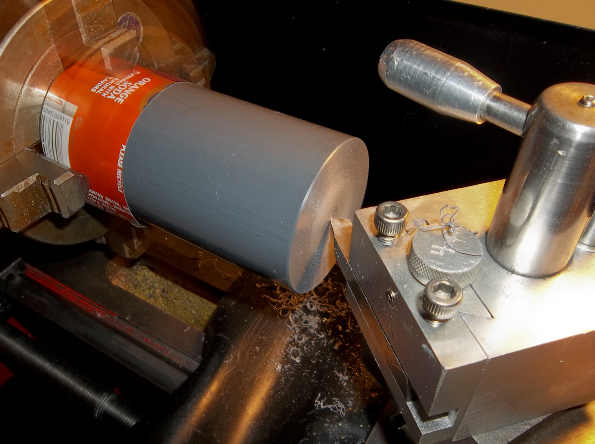

Ok I've put this off long enough.... let the construction begin. :D
I started by cutting of a 4" piece of the 2" PVC Rod on my bandsaw.

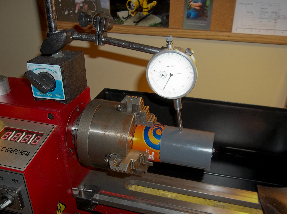

Next that gets centered in a 4" 4 jaw chuck on the lathe.
Then a few quick cuts to clean up the face.

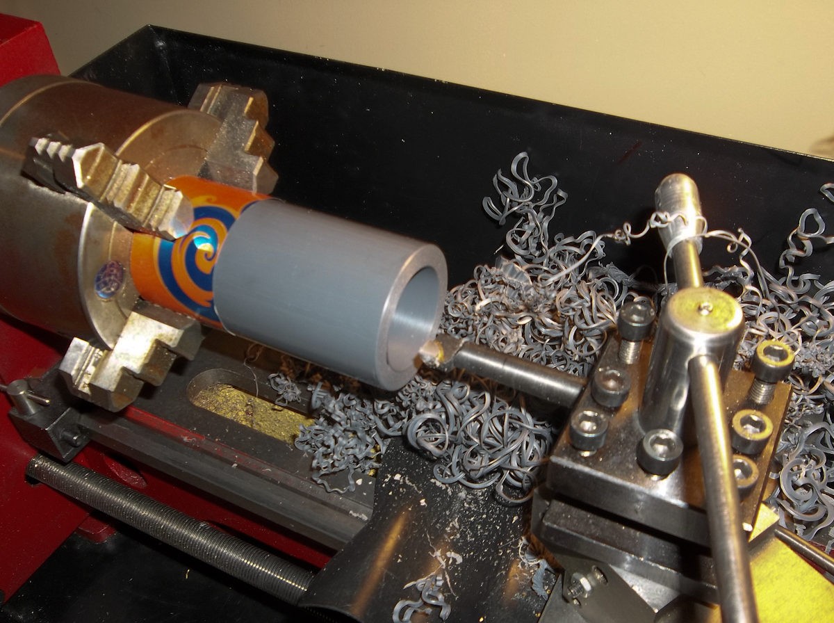

After that I use a few different drills to make a hole for my boring bar.

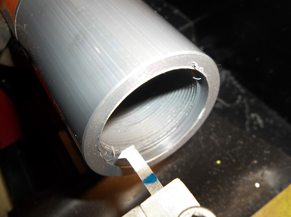

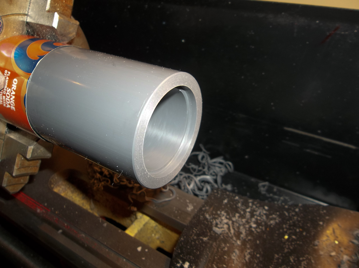

I then bored a hole in the piece leaving about a 1/4" for wall thickness. Everything is pretty much done using the TLAR method (That Looks About Right) at this point.
I had to put a step on the inside edge to allow for a little more room for my internal threading tool as it isn't quite long enough to thread as deep as I would have liked.

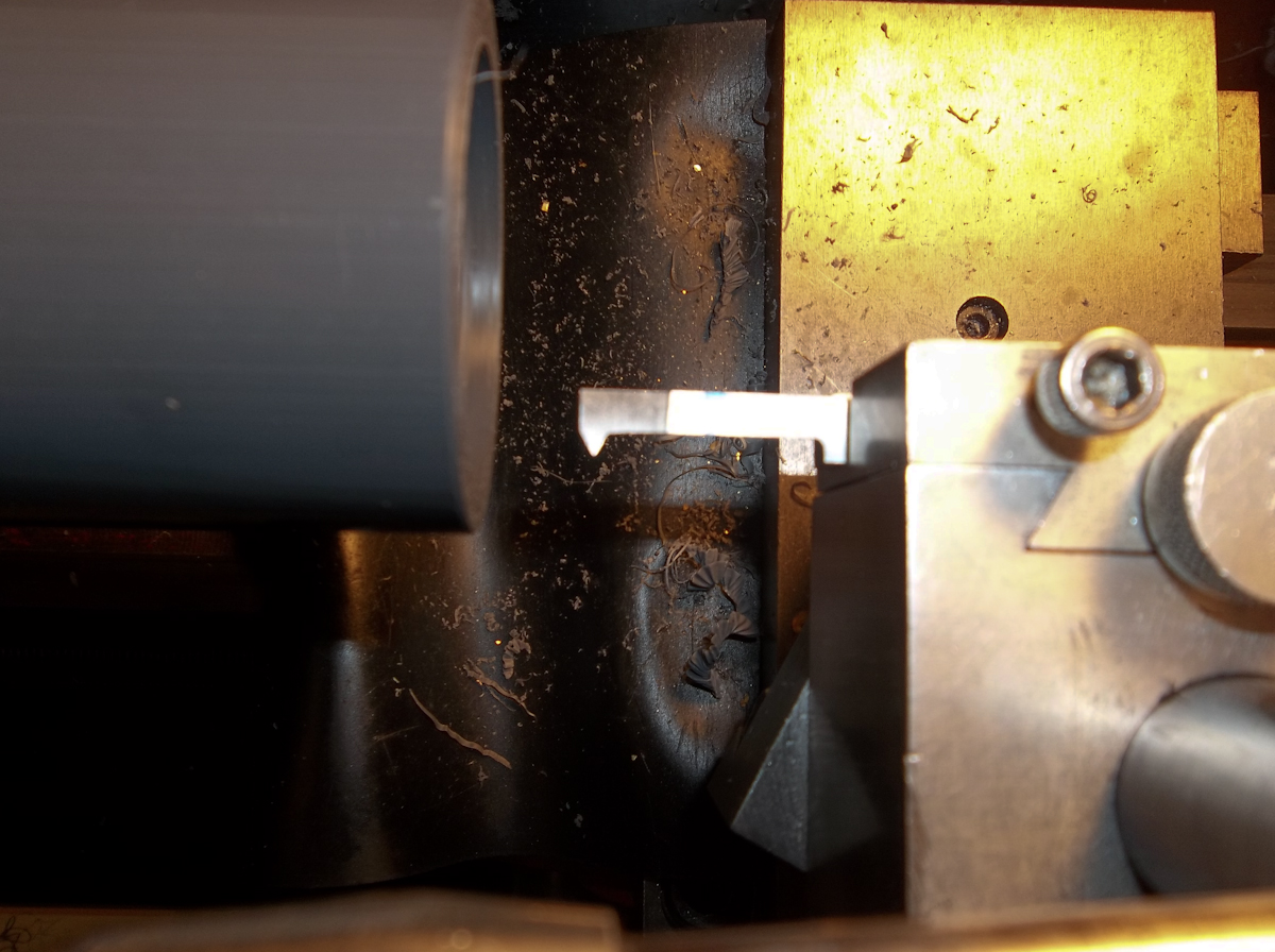

Next I mount up the internal threading tool in the tool holder and hope for the best. (I haven't cut threads in a long time.)

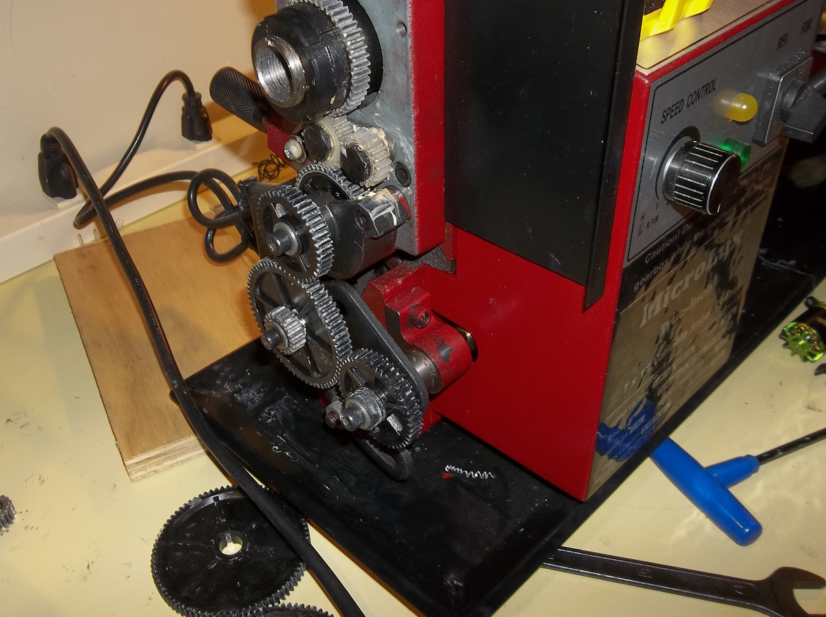

I chose to go with a 18tpi thread for the motor mount. This is done but adding the right gear ratio to the lathe.

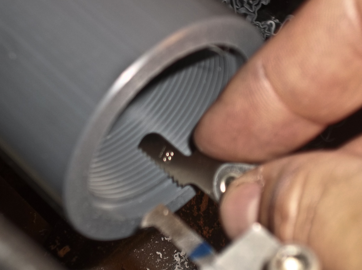

After the first pass I check the cut with a thread gauge to make sure everything is setup correctly.

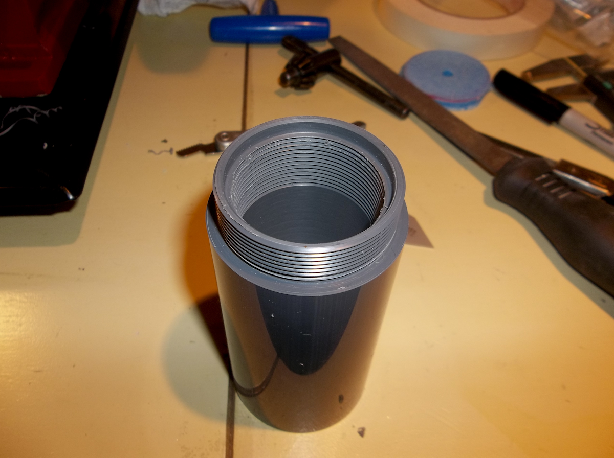

They need a little clean up but here are the internal threads for the adjustable mounter mount.

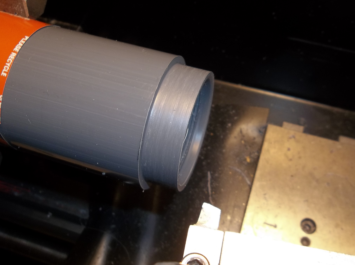

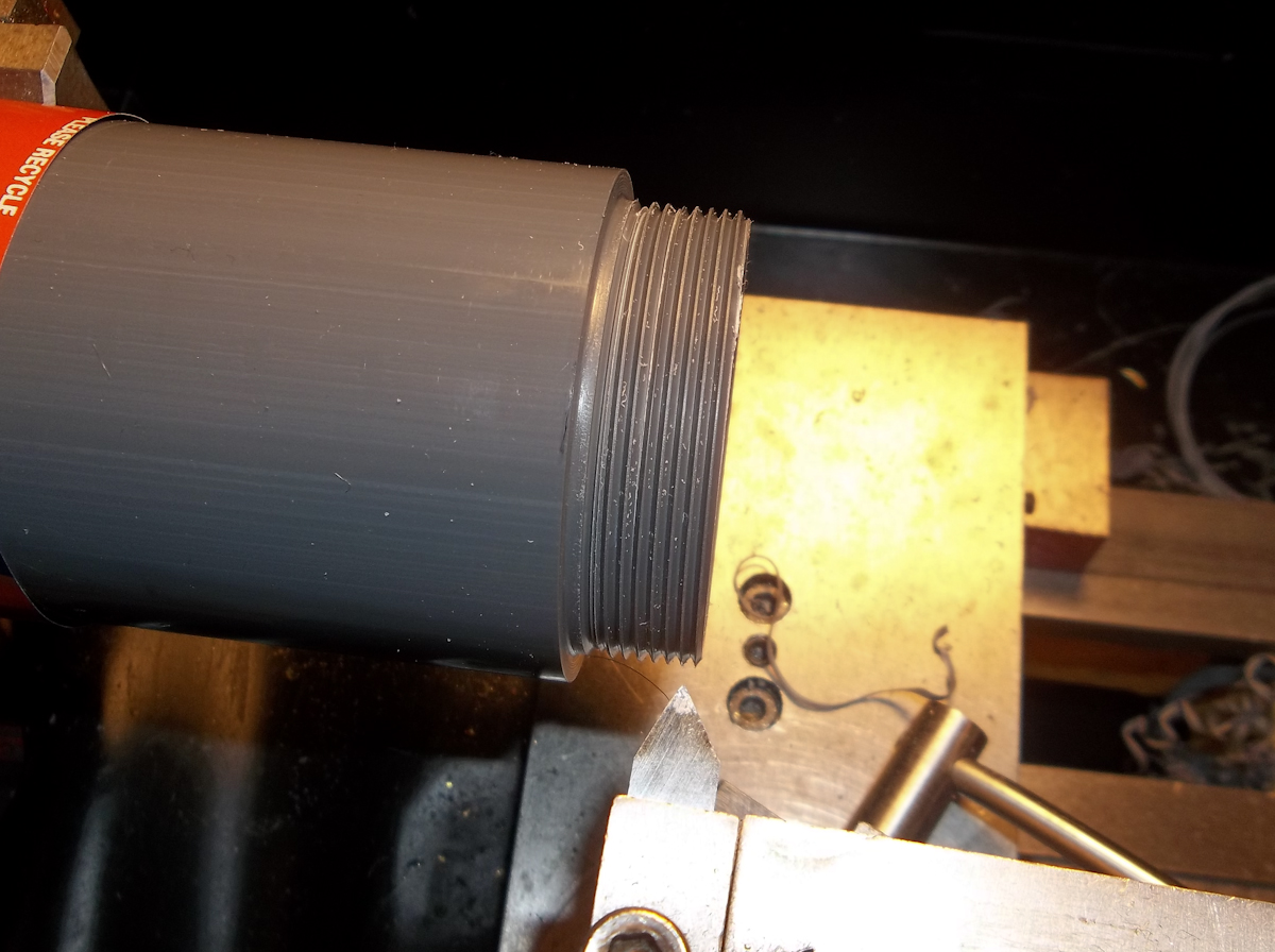

Next I turn down the outer edge for the threads for the rear cap.
This time using a extenal threading bit a cut the cap threads.
So far this is what I have for the rear section of the thruster housing.
At this point I've removed more material than I have left, but that's machining for you....
