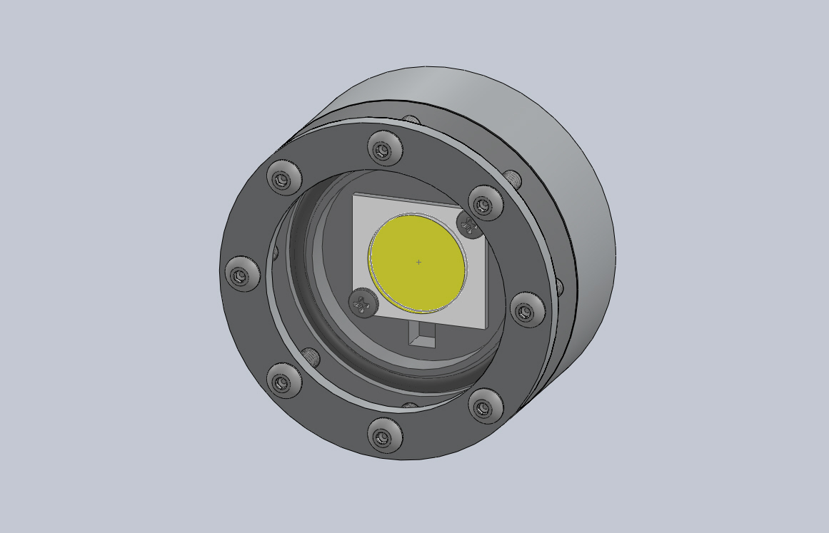

In my ROV, I am going to be using a housing like the image below. I hope to have that manufactured in the next week or so.

- This is my LED housing. The base will be made from 3/4in aluminum. The there is a o-ring and a 3/8in piece of polycarbonate. A 1/8in aluminum ring goes on top of the plastic and 8 pan head screws will tighteten everything down on the o-ring. I am going to either pot the wire connection our use a gland connector from McMaster-Carr.

That looks brilliant! (pun totally intended!)
So from what I can tell, that is just the LED module, and a power supply!? Are you using a LED driver anywhere?

Very nice LED housings. Are you manufacturing these yourself? I have been looking fruitlessly online for off the shelf housings that I can use. I have two identical LED's for my project but to date not been able to come up with a heat sink that will do what I want. I'm using a DC to DC step up regulator to drive the LED's. Plan on potting mine (complete incapsulation) with QSIL 216. It is non electrically conductive, optically clear and a thermally conductive potting compound. That way I don't have to worry so much about sealing the housing.

@KR2_Diving, I think that it would be a simpler solution to just have them on off, and it saves space in the pressure vessel. Maybe a LED driver could be an update or in a version 2.
@bikerbones1968: I am manufacturing these myself. I have some 2.5in aluminum round bar, and I am using a lathe and a CNC to manufacture all the parts.
I am using the aluminum body as a heatsink, and thermal paste between the LED and housing. Because 99.9% of the time I turn the lights on they will be underwater, the water will conduct heat away form the aluminum far better than air. Even in air, these only got to 36C after 5min(attached to a piece of 1.2in Aluminum).
The thermal resistance of your epoxy is 0.18 W/m-K, and 6061 aluminum is 167.156 W/m-K. I am not exactly sure what that data means but if I understand it correctly from some google searches, namely here( http://computer.howstuffworks.com/heat-sink1.htm) then the higher the number the better the material is at conducting heat. You might want to consider at least some type of heat sink because that epoxy may not do the trick.

I have the specs but I think I should have explained a little better the purpose of the potting compound. I will be using an aluminum housing for the heat sink, almost exactly as the housing you are building. Problem is I do not have easy access to a lathe so manufacturing these will be the challenge. My thoughts are the same and to only operate the LED's once submerged and let the water assist in dissipating the heat. The potting compound will be basically poured on top of the LED, encapsulating it from water. This way I will not require a glass lens or an O-ring and collar and worry about having a pressure resistive enclosure.

I figured I paid like 15 bucks each for the LED's and a piece of 2" diameter aluminum round stock is practically free around the scrap metal places here. So I just need to make a "cup" out of the round stock and fill with the potting compound. Its a throw away design but properly cooled and protected the LED should last a very very long time.
Re: Bridgelux 1100 lumen High Power LED's
OK. That makes sense. That design is good for a permanent LED. I believe the LED chips already have some sort of resin on top of the physical LED's, so it should work nicely.
I like the thermocouple idea. What are you using? A k-couple sensor of something like this? http://www.ebay.com/itm/10pcs-NTC-10K-2 ... 3a828ef6ab
I am using a USB cable to supply power, so maybe I can use a wire to send back a temp sensor reading.
I can hopefully swap in different LED's with my current housing design because Bridgelux makes all their LED's with the same square form factor, if a bit different dimensions.
I got a 2.5in x 6in piece of 6061 round stock for $10. Will make four housings I hope. It will probably ~$20 per housing.
