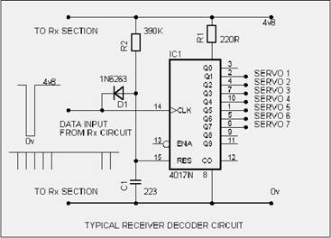

I wanted control a little rov with my Turnigy 9x too ,and with a simple ic and few componant (no programing needed)
You can control about 9 chanel trought a bifilar tether connected on your radio.
Using trainer port work good ,but without parameter on display ...
Another solution, need to connecting inside on the pcb directly, and have your ppm signal when powering your radio .
At the receptor ,a simple cmos counter CD4017 take this signal and produce the 9 servos signals.
I built one and tested it with all radio fonction at about 20 meter with a heder wire like tether,
I transmited my ppm signal and a video signal without any signal loss , think you can work more than 50 meters and more I think ....
It's a very lowcost system ...

But there are some things I have questions about. You are talking about connecting a circut to the receptor, do you mean the Rx unit? And where do I connect it to the Rx unit in that case?
Could you maybe draw me a skecth or something to show where in the Rx the "To Rx section" and the "Data input from Rx section" should be connected? What is also the difference between your circut and the one I linked to in my first post? Seems lite they do the same job?

hi Slimsy,
In first ,did no explain good ,what i'was do .
I realized a direct connection from my Transmitter (turnigy ) to my own built receptor just like this circuit attached in my post , don't use
any commercial receptor, cause internal bus not ppm .

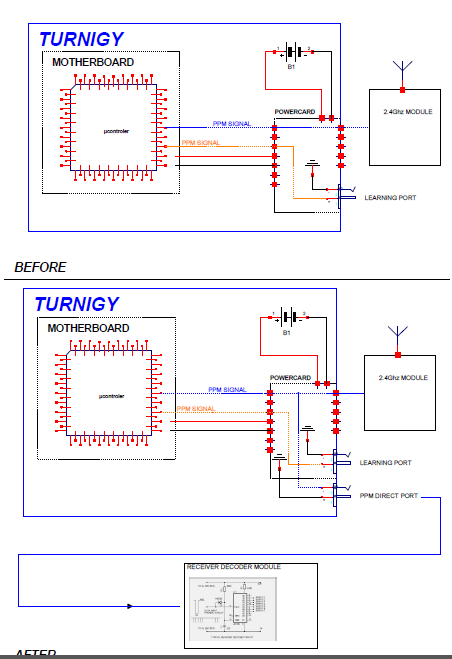

In your transmitter from the main board (where is th µcontroler ) to emmiter convertor (2.4Ghz box witch you can pull behind your turnigy), you have ppm signal witch go the learn port too.
I had just clamp a connection from the emmiter convertor and put a new socket like learn port to can connect my tether cable .
But need some careful ,this modification can be fatalitic to your transmiter if you connect another thing on this port
Can put a shematic for more explain this system if you want ...

Here a very simplist sheme of the modification on the attached document ...
Some people can say ,learning port work too in this configuration :
Yes, allright ,but in power off configuration without the 2.4Ghz module ,and no backlight (if you have one like me ), and you can break the
very thin coaxial wire between your deconnected module and your antenna.
If you module convert ppm signal to effective servo signal ,I don't see why it's not possible work with your Turnigy ...
