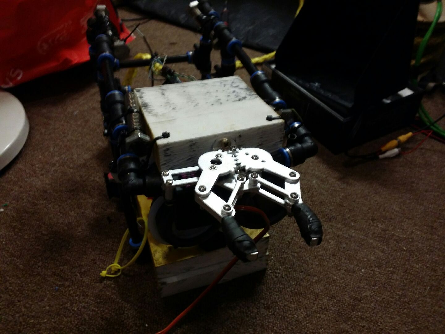

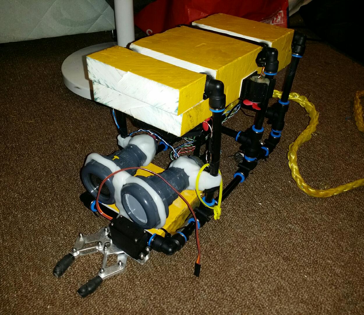

I had bought a little grabber with a view to putting it on my mk2 ROV. but it was a little weedy. .....
So onto the mk1 it goes!
It's mounted on a block of buoyancy that is enough to make the grabber assembly slightly positively buoyant.
I've gutted the servo, so it's basically a tiny reduction gearbox now, and the servo can now run wet, added a micro esc to my topside controller to control opening and closing, then weighted my output accordingly.
Threw it all together and it works, need to now wire it into a pair of my spare conductors in my tether, re trim the whole thing and away we go!
Also running 12v through my escs as opposed to 8.4, should be fine as my electronics are rated for a lot more than they are being used for!
Also want to tidy my topside control box a little more add it's not as tidy as I'd like.
Very much looking forward to my next dive!

Well it was in to the test tank tonight, testing out my manipulator.
It worked well, though my "test tank" isn't really big enough for a proper test :lol:

Well the grabber is an off the shelf, cheap and nasty ebay purchase.
http://pages.ebay.com/link/?nav=item.vi ... 98&alt=web
Then I took a servo, did away with the control board, and now I control the servo motor with a tiny brushed esc.
The servo and gripper are mounted to a block of buoyancy, which in turn is mounted to the frame.

Hi Guys,
Well the grabber was a complete success!!
Spent 2 hours at a previous dive site and managed to get a heap of junk out!
i'm becoming disappointed with my FPV camera though, deffo not enough contrast, i'll have to look into an alternative.
