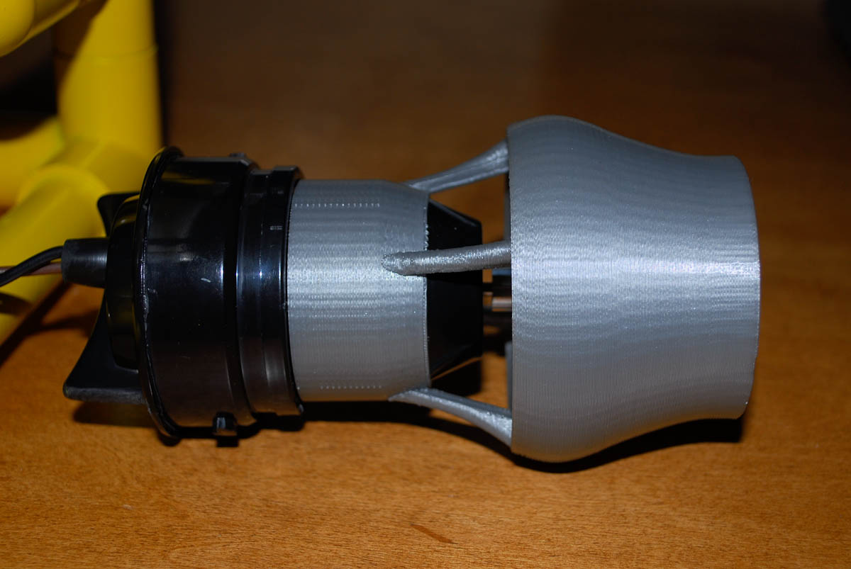

The second one turned out a little better (still printed it fast but at 80% fill) and I fixed the shape of the nozzle a bit too. The first one had a hump on the down slope of the back and I didn't like that.
Had to mount it up on the Rov just to see how it looked.
I wasn't sure what to do for the prop clearance so the first one is about .05" I just need to get it in the thrust tank to see how it works.

Looking ace Steve!!!!
I can't remember the maths for thruster to nozzle clearance, think it's on here somwhere.
0.05" seems like a good realistic clearance though.
Using ABS as you mentioned before you could print one tight and machine it out to get the best clearance.

I did some testing on these today and I'm going to call them successful. :D
The results are....
Without the nozzle
Forward thrust was 2.2 Lbs @ 6.3 amps (12.38 volts)
Reverse Thrust was 1.5 Lbs @ 6.2 amps
With the Nozzle
Forward thrust was 3.0 Lbs @ 6.1 amps
Reverse Thrust was 1.5 Lbs @ 5.8 amps
I'd say that was a pretty favorable increase in Forward thrust with the New nozzle.
Overall I'm pretty happy with them considering I just traced the nozzle pattern from a picture. :lol:

That's a sweet print! I was doing some experimentation as well (viewtopic.php?f=3&t=1464) it seemed that, honestly, my arbitrary one had just about the same amount of thrust for prop speed. Have you tested any other airfoil's (Hydrofoils?) and compared? for my total of, like, two tests it made me feel like the specific airfoil wasn't nearly as important in this comparatively low thrust environment, as opposed to a large shipping vessel.

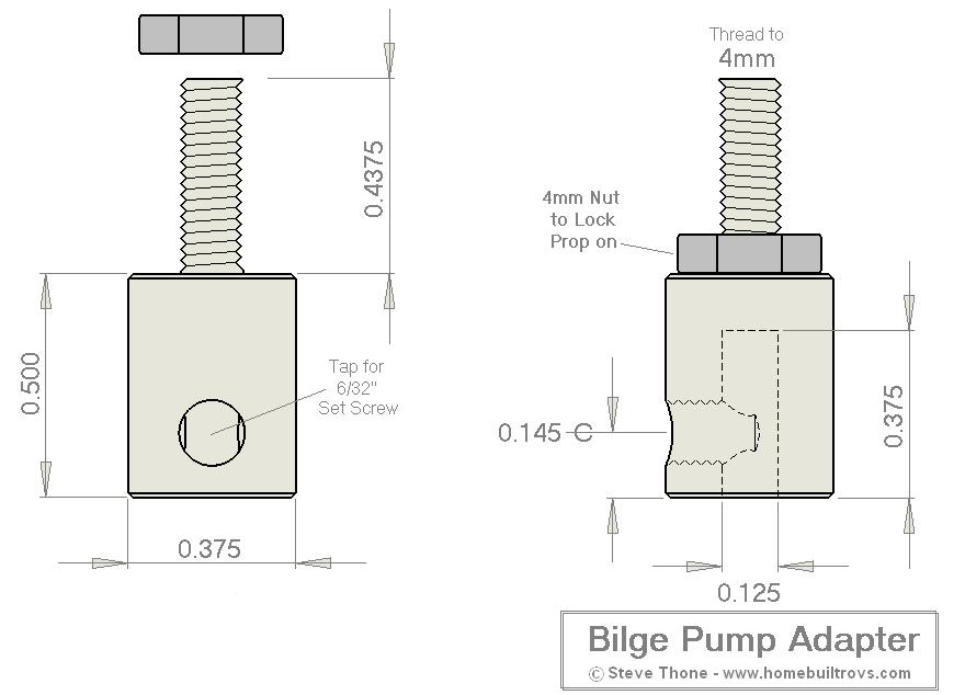

The pump cartridges insert and lock into the housing much like the original bilge pumps they were designed for. They are designed to use Robbe three blade 50mm props available at http://www.harbormodels.com and the custom prop adapters the specs are Shown Here. (I'm not sure how different props or adapter lengths will vary the thrust results listed else where in this thread.)
