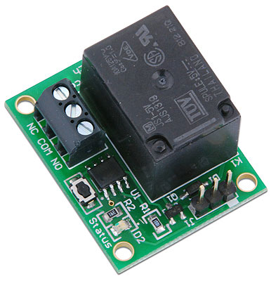

The servo relay I use is this one.

The basic Micro relay that is what you are turning your outside lights on and off with? Does that plug into the Rx

Yes it plugs into the RX on a spare channel. IE channel 5 in my case the gear switch. I am actually using it to switch on and off the LED power supply (line side) About 4 Amps. I have been in the water a few times, not happy with my tether not being neutraly bouyant. Trying to source a better thether from sebotix or video ray. Also my dive video sucked. The water was so saturated with alge I couldn't see Sh!t. Been so busy with other projects I havent updated the build thread to show all that has been done. Winter is coming and I will get back to some updates for everyone and some ice dives planned in clearer water.
