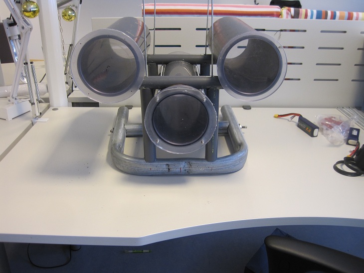

Post by sigplyrn »
Maybe not the most aerodynamic ROV, but it's made on a low budget :) Just need to make the sealing for the tubes at the back and I can check if it is waterproof.
