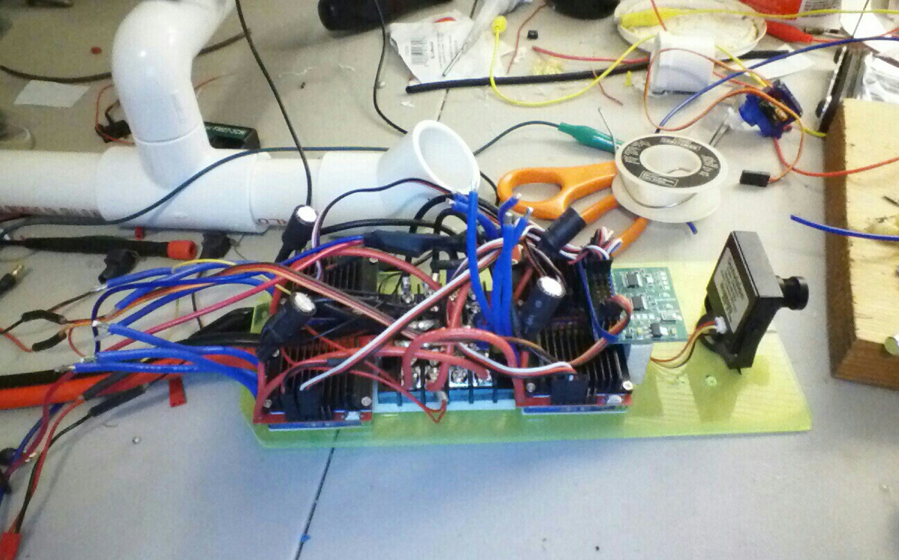

Re: Archerfish 1
My control board...
Pretty simple. Four ESCs, a camera, a ppm to pwm converter, a brushed esc for the lighting, and positive and negative buss bars.
