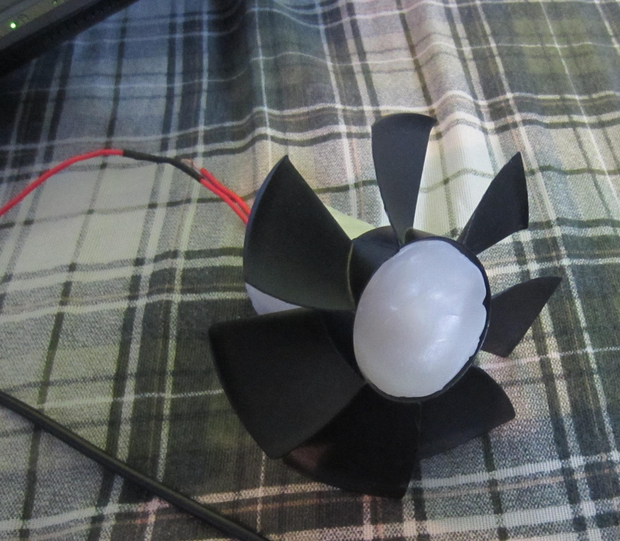

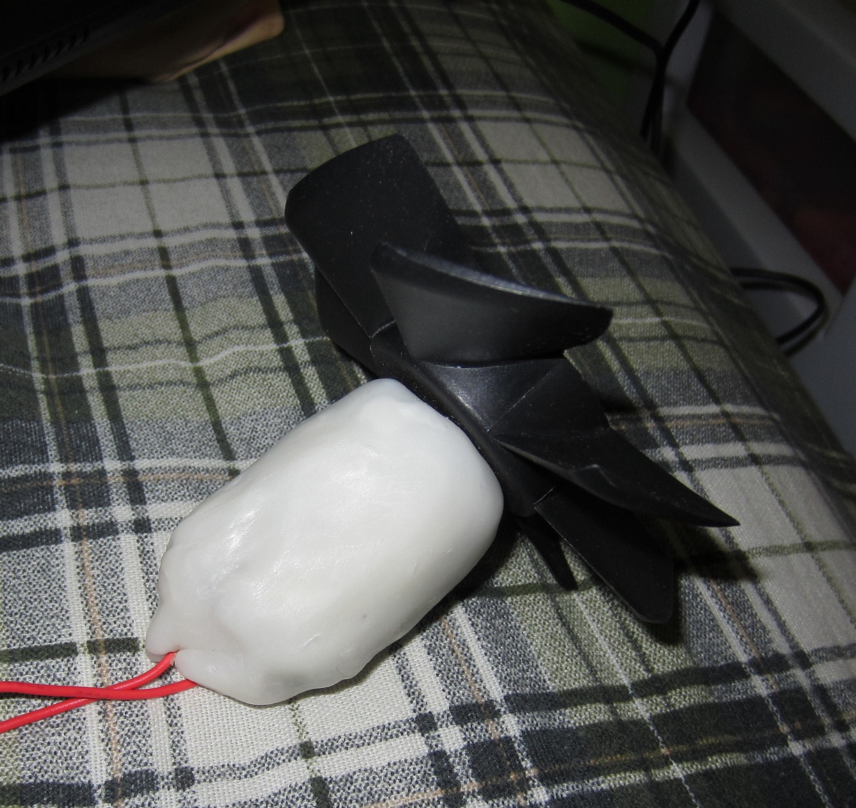

So I was looking through my junk bins looking for something to use on my ROV and stumbled upon an old computer cooling fan that I had scavenged out of something. Since then I have mounted the plastic blades to a R/C plane motor and have conducted a couple of non-scientific tests to see how much thrust seem to be given by this motor-prop arrangement. so far I have operated it under water and it does seem to give a sizable amount of thrust. I also did another test where I mounted it on the bottom of a 2 liter bottle and sent it across a water tank. It worked pretty well! Here is the motor I am using:
http://www.amazon.com/HobbyZone-Electri ... B0006O3CSW
the prop is just a generic fan prop with 7blades and a diameter of about 3.5-4 inches.
Specifically this one: http://www.ebay.com/itm/Delta-DC-brushl ... 4ac2ebbc21
Also I water proofed the motor using a plastic called shapelock, which is super amazing
http://shapelock.com/page5.html

- IMG_0835.JPG (520.01 KiB) Viewed 9631 times
- IMG_0834.JPG (471.99 KiB) Viewed 9631 times

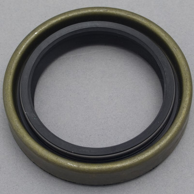

Oh, and Scuber, so far just as far as static surface tests go, I haven't seen any air bubbles leaking. I did do some research and found some examples of motor shaft seals. Most though ofcourse are too large to use on a small motor shaft, but the seal shouldn't be that hard to build. If you took a small bearing and a rubber cork, put the shaft through the cork and the cork in the bearing and then attached that assembly so water couldn't get underneath of it, that could work.
