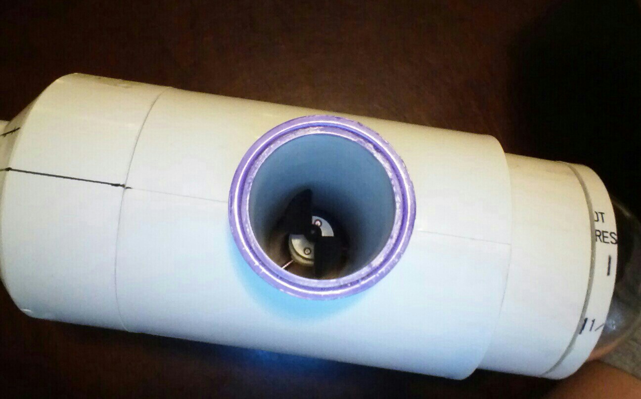

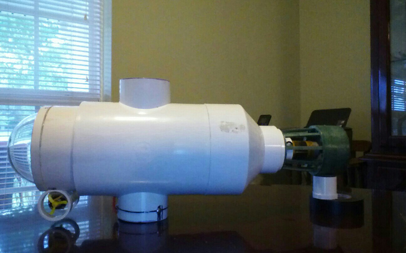

I started a new one. I saw these 4x2 reducer tees and got this design in my head.
This will just be for pool use. It will use a vertical thruster inside the sleeved 2" section of the cross, a single rear thruster ans a bow thruster for steering. I may have to add a rudder too, I won't know till I see how much authority my bow thruster has.
The dome is from a Harbor Freight fake security camera... thanks to Chriz0138 for that.

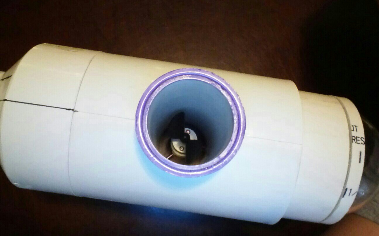

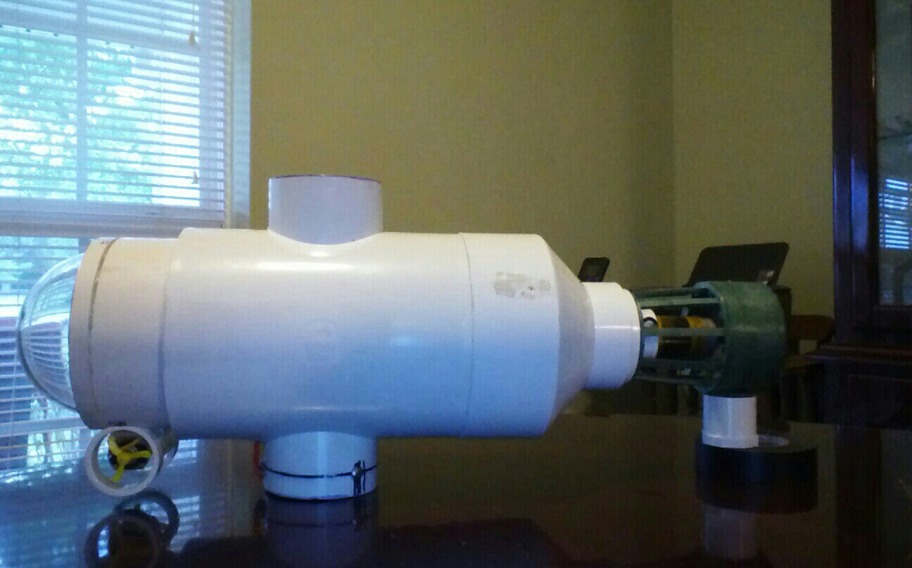

I really like what you've done with the strafe motors! Can you describe the bottom seal and latch (or at least that's what it appears to be) and whether you'll be using the opening for an ascent thruster? Is the camera fixed or do you have pan/tilt (or is it just sitting in there for appearance :) )??
Heaps of progress!!!
Re: The Guppy
The camera will be functional but will be stationary. This rov will actually be radio controlled and will only use the tether for video purposes. It's for very shallow use only (15 feet or less)
The lateral thruster is a double shaft 12v motor with two 30mm props. It is located at the front for steering so the vehicle won't move laterally. The advantage over a rudder is that it does not require forward motion turn around.
The vertical tube does indeed house my vertical thruster and there is no access point on this model once it is sealed.
I am going to use flowable silicone windshield sealant on the joints and spray the whole thing with aerosol plasti-dip.
The batteries will be sealed inside but the power will be switched by means of two jumper wires on the outside of the hull.
If I ever have to open it back up I will have to cut along a seam and peel off at least some of the plasti-dip.
I'll let you know how that works out. It was just too expensive to design in a sufficient access port.
