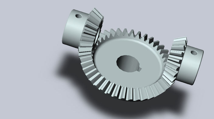

However, there is a much simpler solution if you want a single joystick to turn both pots (potentiometers/variable resistor/knobs). Use 3 bevel gears (see pic attached), the centre one with the stick attached at right angles, the pots on the outer gears. This is what I would have done before getting into microcontrollers.
Just have to make a simple support or box around the gears to hold them together, and swap outer 2 wires on one of the pots. Hope this helps
