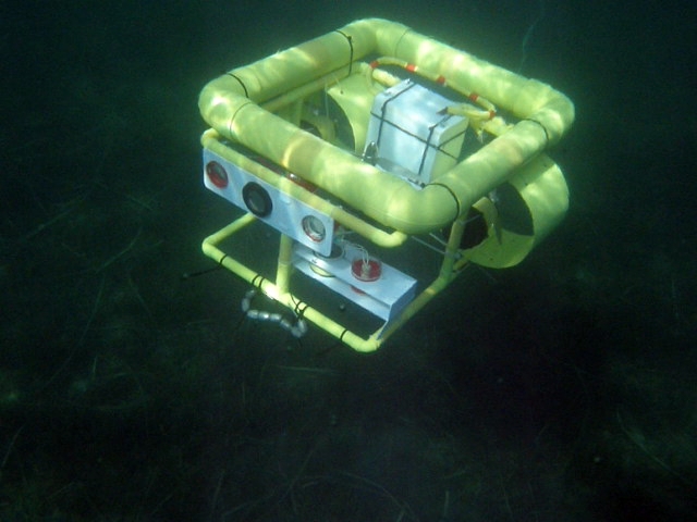

- At last in the water!
- Triton_first_dive.jpg (153.73 KiB) Viewed 5575 times

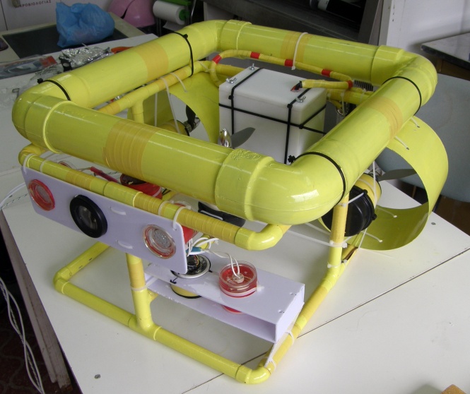

- Triton assembled and ready to dive!
- Triton.jpg (116.24 KiB) Viewed 5575 times

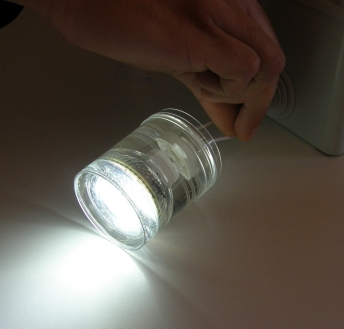

- Potted LED light test...
- ROV_Headlight.jpg (63.72 KiB) Viewed 5575 times

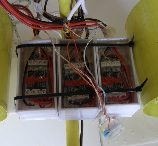

- Potted DPDT relays
- Potted_relays.jpg (87.13 KiB) Viewed 5575 times

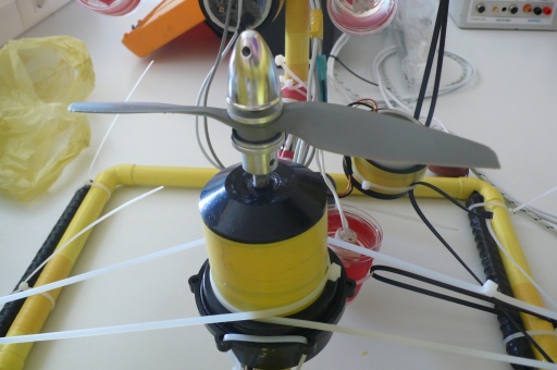

- Lift motor, collet adapter and prop
- Lift_motor.jpg (59.93 KiB) Viewed 5575 times

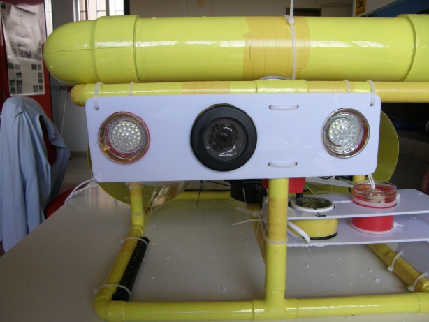

- Front camera and lights
- Front_camera.jpg (81.34 KiB) Viewed 5575 times

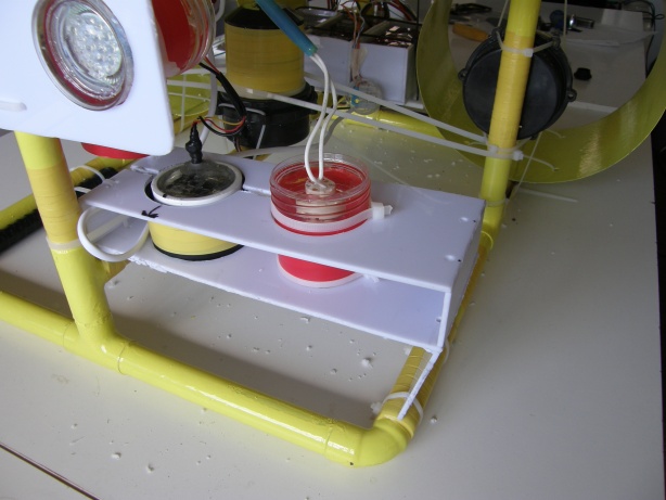

- The camera and light for seabed view
- Down_camera.jpg (81.25 KiB) Viewed 5575 times

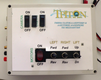

- The control box
- Control_box.jpg (93.12 KiB) Viewed 5575 times

Great build! Looks pretty "bomb proof!" or at least field work proof!
Well designed and laid out!

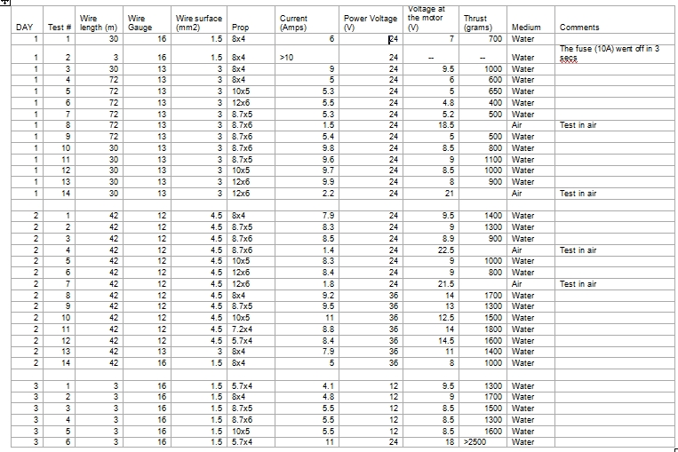

The props are fine. The bollard test I made gave about 1.6kg of force for each motor which is quite adequate to manoeuvre it.
I made a lot of tests during the summer and you can see my results in the file (I can't attach excel and word files in the forum, is this normal?).
I had good results with the 8x4 props when chopped by 1cm on each side.
I haven't chopped the mounted ones yet, since the differences were not so high.

- Bollard test data
- Bollard_Test.jpg (272.23 KiB) Viewed 5555 times

Great info! Lots of tests!
Any issues with the prop adapters coming loose when spinning "backwards?" Have you secured these using any sort of glue or thread lock?
Ryan "KR2_Diving"
Ryan "KR2_Diving"
Re: Triton Project
Yeap! They are getting loose sometimes on reverse, even with 2 nuts on the adapter. Haven't yet fixed the problem permanently, but it seems that if you tighten the 2 nuts and the front part of the adapter it's ok. I'm planning to try some "secure" nuts (these with the plastic coating inside.
Alex (Triton)
Alex (Triton)

Re: Triton Project
Great looking project. To prevent my props from getting loose I just used epoxy on the prop shaft slid my prop on and tightened it down with the locking nut. It seems pretty robust and secure.
Re: Triton Project
Thanks for the tip!
Is it easy to un-screw though? I disassemble the props after each dive for maintenance.
- bikerbones1968
- Posts: 374
- Joined: May 10th, 2012, 5:21 pm
- Location: Annapolis Valley Nova Scotia
- Contact:
Re: Triton Project
I would imagine it would be very hard to disassemble them using epoxy. I will not need to phyiscaly remove my props. I am using brushless motors that will exposed to the water, flush with fresh water, blow dry with compressed air and a quick shot of non conductive lubricant and put it on the shelf.
Re: Triton Project
I had thought it would be difiicult. I disassemble the colet adapter and the props every after dive, because at my first ROV the adapter and the shaft became 'one thing' due to corosion (I used to just rinse them with tap water after every dive). When my motors broke, I had to throw away the adapters too and managed to save the props after I cut the shaft and the adapter. Now, I take the adapter off the shaft, disassemble everything, rinse them with tap water, grease them with lithium grease and reassemble everything until the next dive.
I'm now sure that my next design will be equipped with brushless motors. But until then, I hope I'll make some dives.
