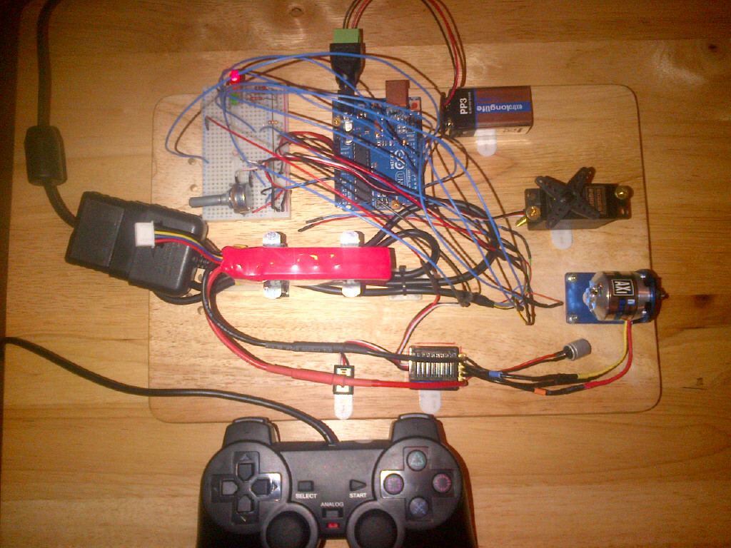

Every programmer who has ever tackled a new programming language knows that felling of triumph that a flashing LED, the proverbial "Hello World" of a hardware programming, is the first giant step towards success!
If that is the case, a few beeps of an ESC and the whir of a motor must be the equivalent for an ROV builder!
It is not much to look at yet, but here is the first shot of my Arduino powered ROV, yet to be named...

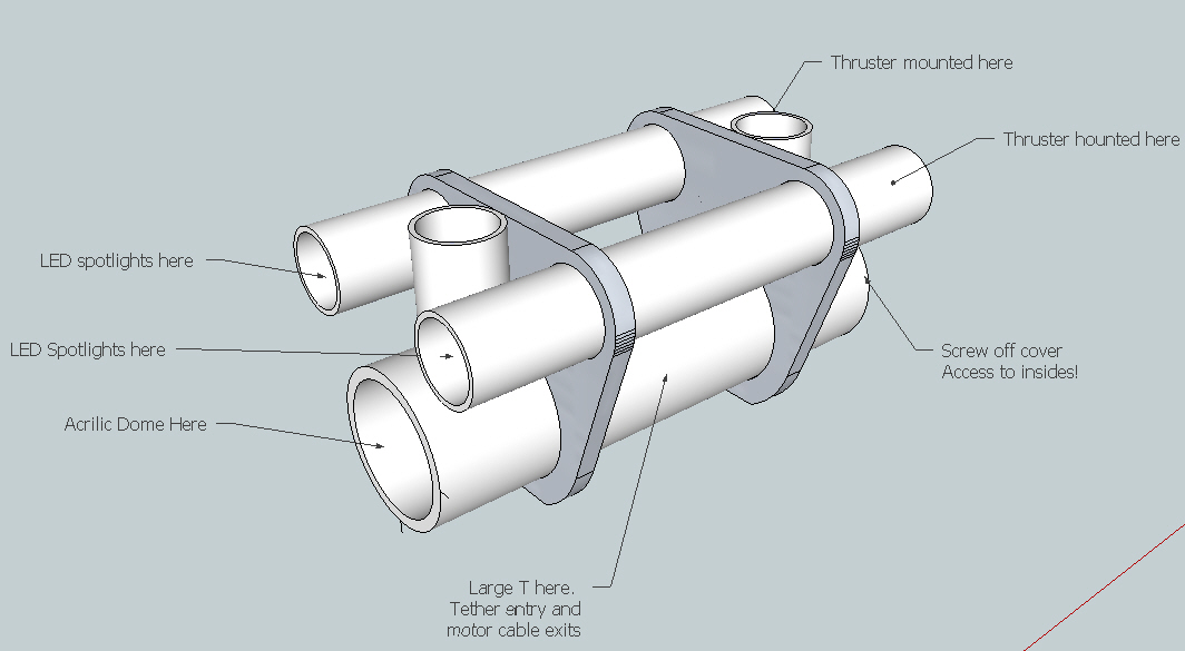

Things are coming along with my yet to be named project! I have been doing some calculations on my hull design, and I think I have a general design concept picked. I will have to wait until December when I am back in the States to get the supplies to build the hull as PVC is not so readily available here in the UK, and half of what I need is out in my parents barn!
(see sketch below!)
With this design, if I were to just cap of the ends of all the pipes, I would still be 6kg positively bouyant. (Pipes only, not batteries, motors, or anything else for that matter.)
I am sure my gear will be less then 6kg, so it will be interesting to see how it pans out.

(see sketch below!)

- First Draft of ROV hull design.

Sounds like you sure have a great plan there. I really like the brushless motors you went with. your drawing looks great!!!

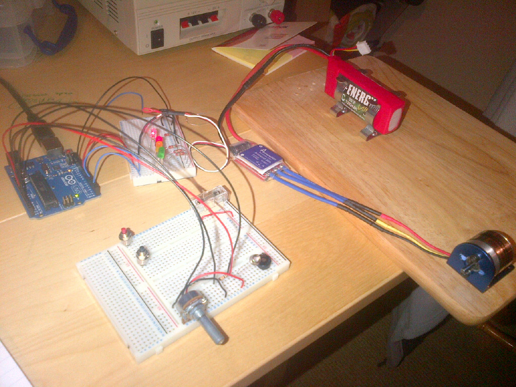

Great news!! Spent my Sunday trying and succeeding in using a Playstation2 controller to control a Brushless motor with reversible ESC!
Once I get a chance to clean up the code a little, and add some comments, I will be happy to share with anyone interested.
Even managed to hack the bread board from the kitchen in the process!
Thanks to Deakel for pointing me in the right direction!

- How many bread boards to you see in the pic! :D
