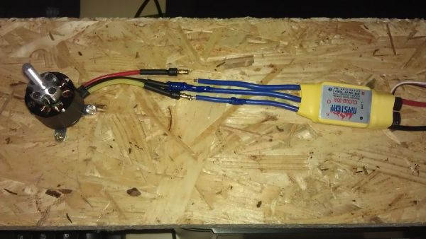

I want to use the brushless motors with ecs for thusters. But I found out that I have to buy the ones with reverse. To control it I'm using Arduino Mege 2560. I'm slowly getting familiar with that with a strong support of my cousin, who is a programmer. Still wonder if I can really put these motors into the water... I'll try it when my props (44mm diameter) will be delivered.

brushless DC 750kV motor

I'm planing 4 pcs of Gel batteries, controll system and the cam to be inside. The batteries are pretty heavy and about 10x15x7cm. I thought the floating pipes would help the stabilization. I'll see when I asseble all the parts of the mail hull. Also I'm pretty sure I'll have to use some ballast. Thanks for comments.
I'm wondering if a 750KV brushless motors will be enough to move my ROV.
