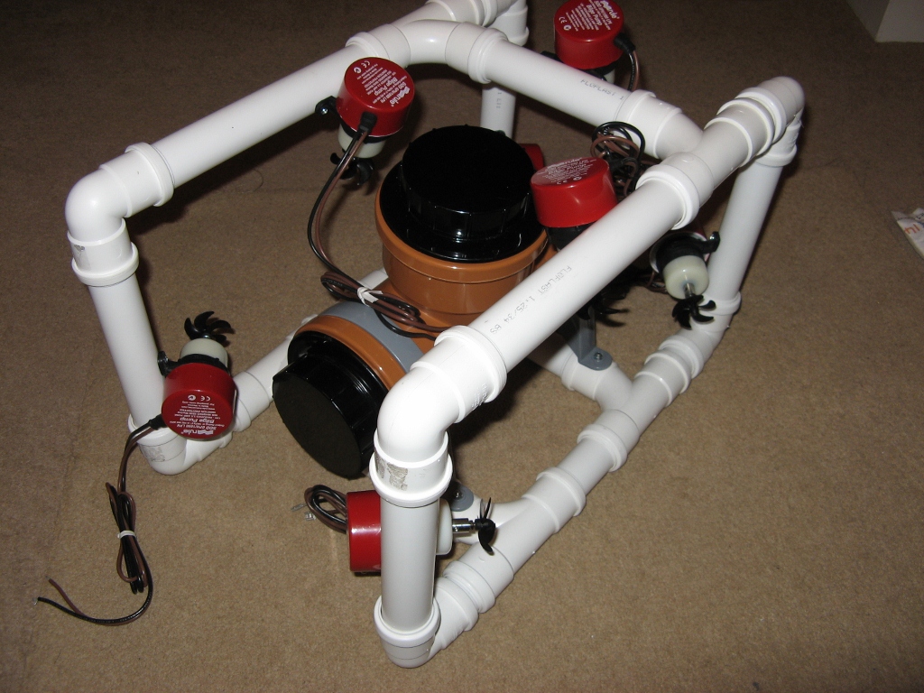

I have completed my university electronic engineering project to build an ROV. I have a project page at http://mbed.org/users/scotto/notebook/scottrov/ where you can download the full project report.

I'd like to see your thruster placement. Would you mind posting a pic or two of the finished rov out of water that shows where all the thrusters are placed and which direction that point?

Does this help:
Re: University project finished
Nice vectored thrusters. What propellers did you use? Looks great overall!

yeah, that is what I was looking for. thanks!
so why the 3 vertical thrusters? I don't see an arm or other reason the balance of the rov would shift.
