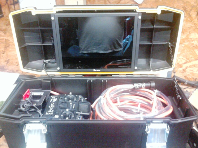

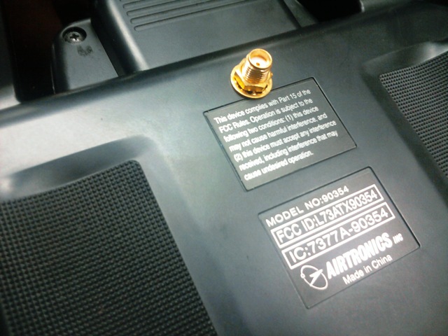

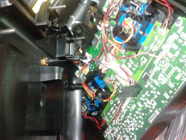

Option two(the option we employ):
We purchased a Ufl to SMA bulkhead fitting, digikey p/n ACX1894-ND, then we opened up the Tx and pulled the antenna wire from the circuit board and snapped the Ufl connector onto the board. A small hole was drilled in the back housing of the Tx and the bulkhead fitting was installed. Its pretty simple now as we have a coaxial wire that screws into the back of our controller. The coaxial wire travels down the teather and then is just stripped back to expose the center conductor inside the control box onboard the ROV. The control signal can simply travel the few inches form 'antenna' to Rx and we have a completed circuit.
For reference our controller is an Airtronix RDS8000, we even use the 5th and 6th channel to trip a couple relays to switch camera views and to energize an electromagnet.
I can capture some pictures if anyone is interested.

internal pics I've found of the turnigy 9x indicate that it does have a u.fl connector for the antenna.

We had another controller that we simple desoldered the threaded fitting and repalced it with a coaxial cable out the top. the Ufl made it super easy though to make sure we stayed shielded the whole way. I will try and get some pictures tonight.

- Inside controller

- Back of controller

- Opened control box

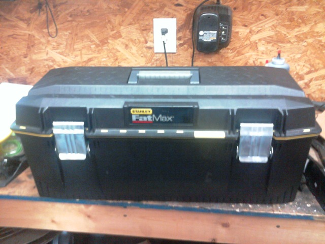

- Closed control box
