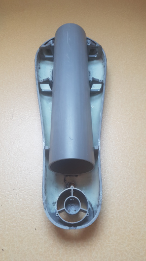

I took a break and did not posted for a while, but I managed to build the bottom of the hull entirely. So nice to see the thing taking shape!
I said that I would not require epoxy on this new model. That was before noticing how easy it was to crack the parts that came out of the printer! My mistake was to draw very thin edges (1.2 mm) on the sides, which makes them fragile between each printed layer. Once a crack occurs somewhere, it can easily propagate...
So, I took the resin and fiberglass back from the cave and started laminating the whole thing! Here you can see the result. I used two layers of fiber.
I know, it's a bit rough - but at least it's strong enough to withstand shocks now!
The white color comes from a primary paint for plastics and resin I applied before laminating. But I tested without paint on a wasted part, and the adherence did not seem bad either.
that's what it looks like with the pvc pipe and the bottom frames:
