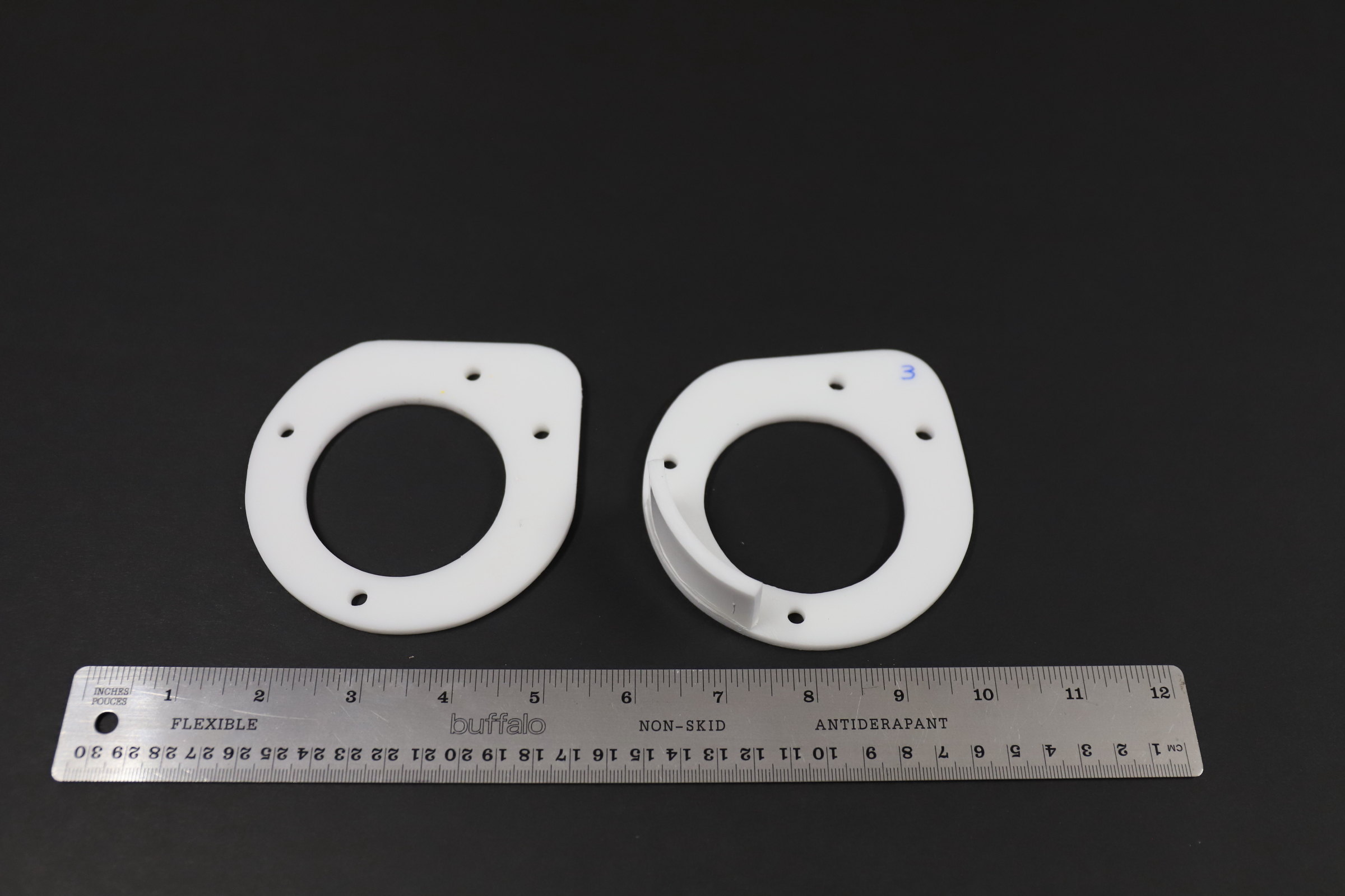

Starting my first ROV project on the fly and on the cheap. Dismantled a homebuilt Hexacopter (too many rules these days) and using as much as possible for the ROV. Also using some 2nd hand joysticks from a garbage truck control panel to control the thrusters.
I used Adobe Illustrator to design the brackets and motor mounts and then cut out cardboard prototypes on my Cricut to check the look and fit. Once I was happy with the design i would transfer the profile to acrylic and cut it out. Below are some of the parts. The motor mounts are actually discarded aluminum serial plates that I repurposed into mounts. They slide into the PVC pipe and hold the motors in the center. I have a automotive back-up camera as my main camera and a GoPro mounted for better quality footage. The front dome is a piece of acrylic heated up in the oven and then put in a home made fixture to allow it to bow out when compressed air was applied. It took a couple of times to get the temperature right and it worked but I could have used one more shot at it.
Thruster Assy.JPG (230.66 KiB) Viewed 97149 times
Thruster Assy Front.JPG (332.64 KiB) Viewed 97149 times
Thruster Brackets.JPG (266.71 KiB) Viewed 97149 times
Motor Mounts.JPG (352.02 KiB) Viewed 97149 times

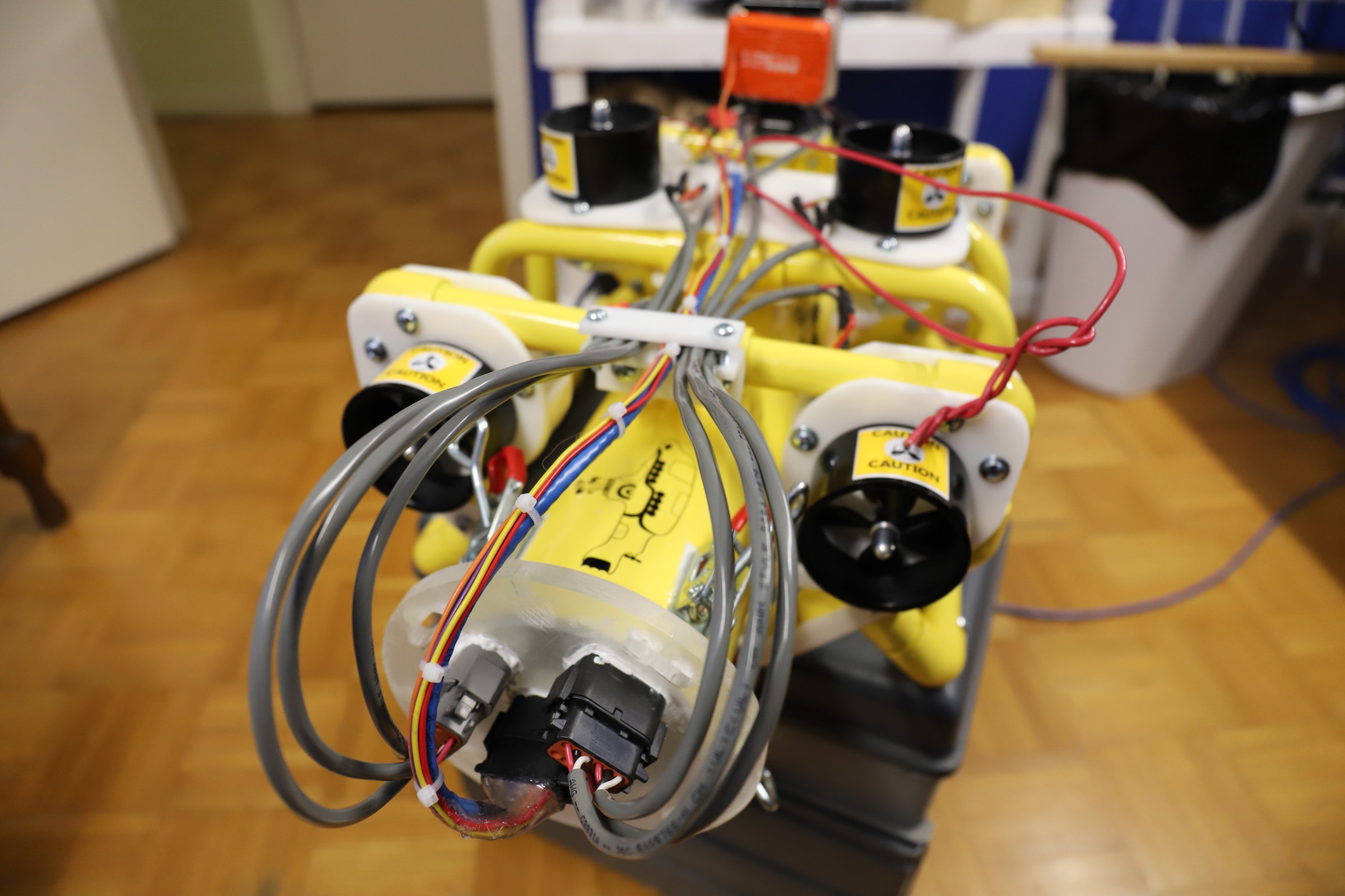

Rear View.JPG (403.89 KiB) Viewed 97149 times
Front view.JPG (484.98 KiB) Viewed 97149 times

Good night from Spain.
I'm glad you cheered up to make an ROV.
Your design looks nice, but I think I should make you several recommendations.
Brushless motors have nothing wrong if they work submerged in water, but we're always talking about "clean water," such as in a pool, or a bathtub, but if we talk about open water, a swamp, a reservoir or at sea, we're no longer talking about "clean water," there are always suspended particles, ready to enter through the most unsuspected corners for the sole purpose of ruining your project , so you have to be careful with that. If you're going to use your ROV in a pool, don't do anything, if you're going to use your ROV in other types of water, you should think about how to better protect your engines from contact with water and its suspended particles.
As for the connections, in the photo I've copied from the ones you've posted, I see that you're using connections from those used in automotive, I have nothing against such connections, but you have to find a way to protect those connections from water, so that you don't get water into the dry chamber of the ROV , and wet and ruin your electronics. For example, by putting fast superglue glue, or covering them with exposi resin, in the part where the wires are, you can't imagine what they're capable of destroying a few drops of water in contact with electricity and electronics.
Rear View.JPG (403.89 KiB) Viewed 97116 times

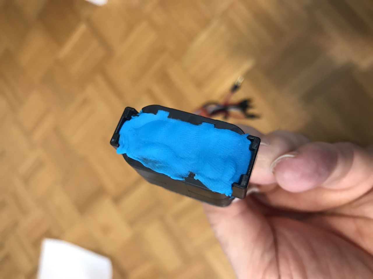

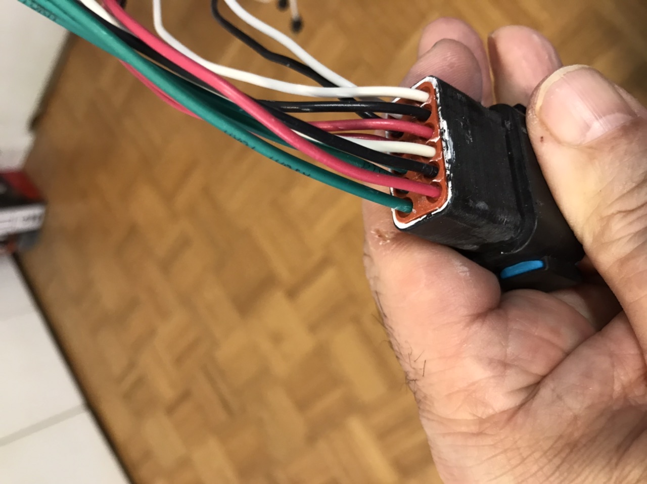

Thank you for your ideas regarding the build. I’ve seen builds with brushed and brushless motors and like I’d said in the original post, I’m using parts from my hexacopter on my first one. Based on what happens with this real life experience on this side one ROV #2 maybe a different configuration?
I’ve attached some photos of the connectors and I too were concerned about the sealing of the unit. You can see although they look like standard automotive connectors, I’ve filled them with epoxy. I kept the rubber seal at the edge because I was afraid the sharp edge of the epoxy might affect the cable over time if it were flexed too much. I filled the pin side with putty to stop the epoxy from filling in that side and then filled the other side with epoxy and let it flow in to all voids.

I like that already, in these photos it looks better that you have been careful to protect the connections, however, I would cover with the same the red part of the connector, where the cables are hooked, to improve the sealing.

In this part of the connector

Muchas gracias asesorplaza1
Below is what I’ve done to one of the other connectors. Maybe I will do the same to all.
My plan is to submerge it in a pool with no electronics in it to test for leaks before installing everything inside. I also have to work out the buoyancy because I will need to add some to get to neutral.
