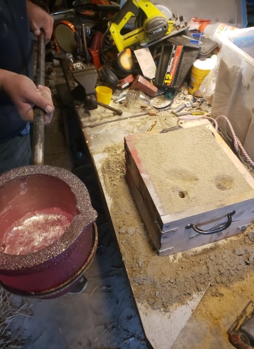

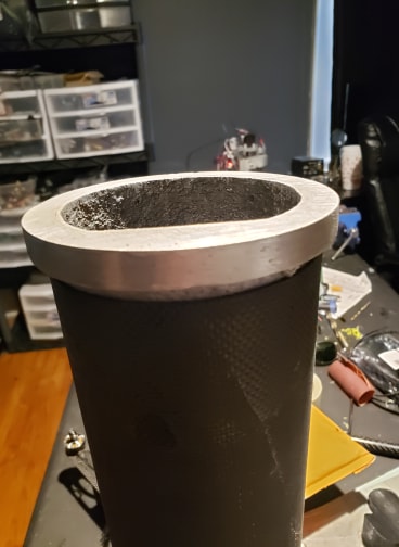

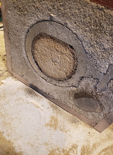

Was only able to cast one flange this morning, but there's the pictures from todays adventure.
Plug
Plug
Pouring
Pouring
The part in the sand cast.

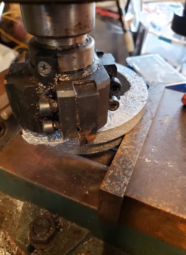

My buddy decked this for me right after the cast, his mill needs to be trammed but it knocked all the high sides off

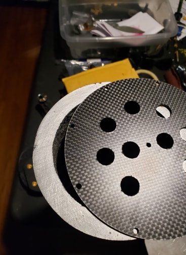

I need to grab a drum sander for my drill press to clean the flash out of the inside and probably resize the print.

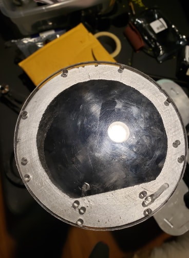

Don't mind the holes in this part, it was my practice lexan the other one is cut and I left the plastic on to prevent scratches.
looking glass.jpg (40.14 KiB) Viewed 11003 times

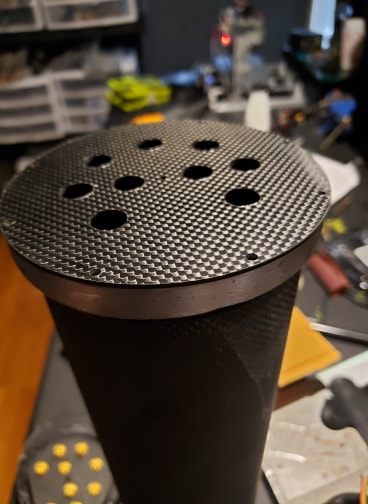

Need to clean the flashing up on the outside so it fits into the tube.
