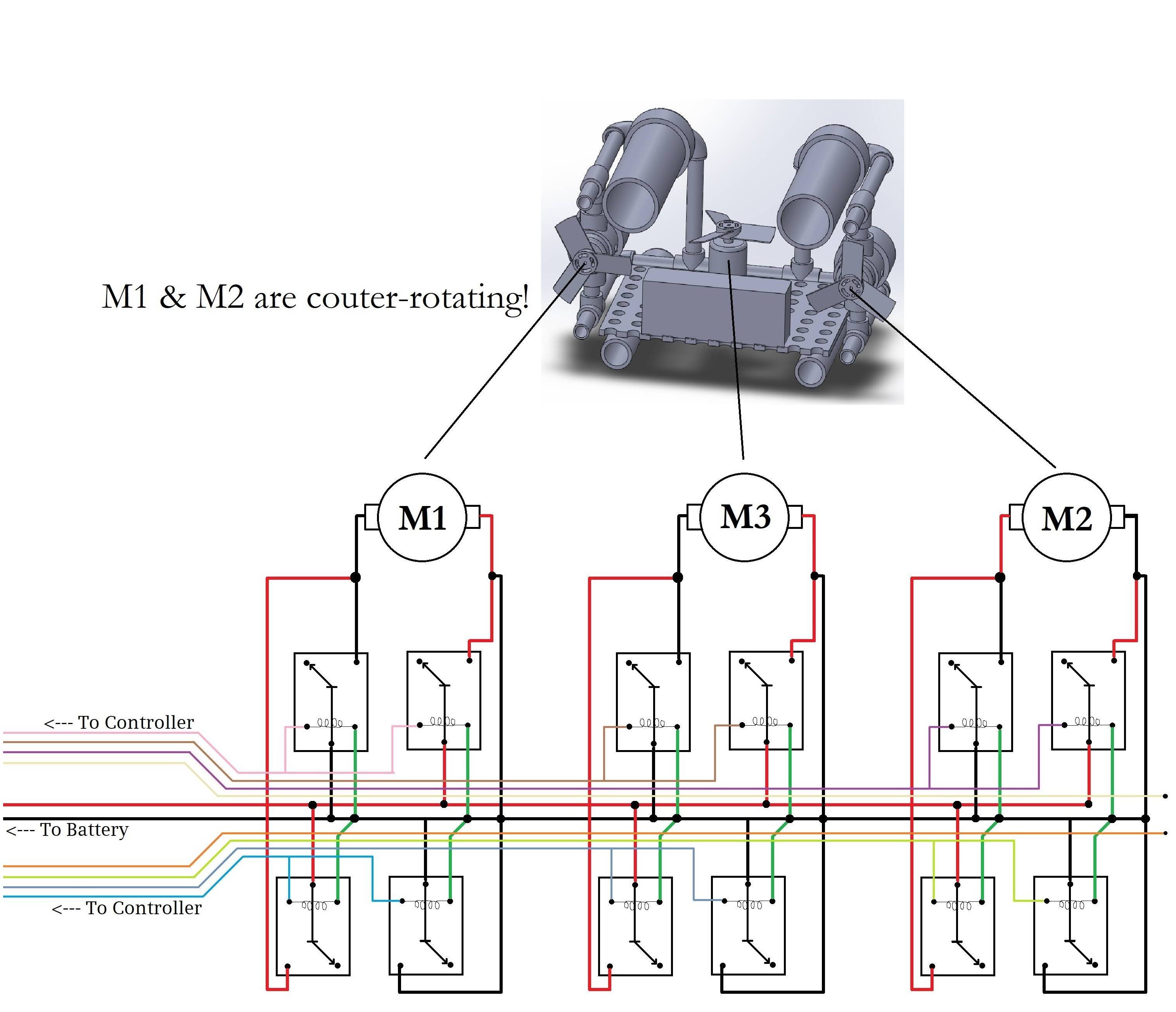

Thanks for the information! I'll look into adding these things as I continue to test my ROV. And about your questions, the IC's consist of a PIC16F690 microcontroller and an ULN2803A Darlington transistor chip, the PIC takes the button presses and fires the coils of the relays which control the motors. I'll attach a schematic of the whole system.
Control Schematic pt 1.jpg (318.48 KiB) Viewed 10633 times
Control Schematic pt 2.jpg (453.09 KiB) Viewed 10630 times
