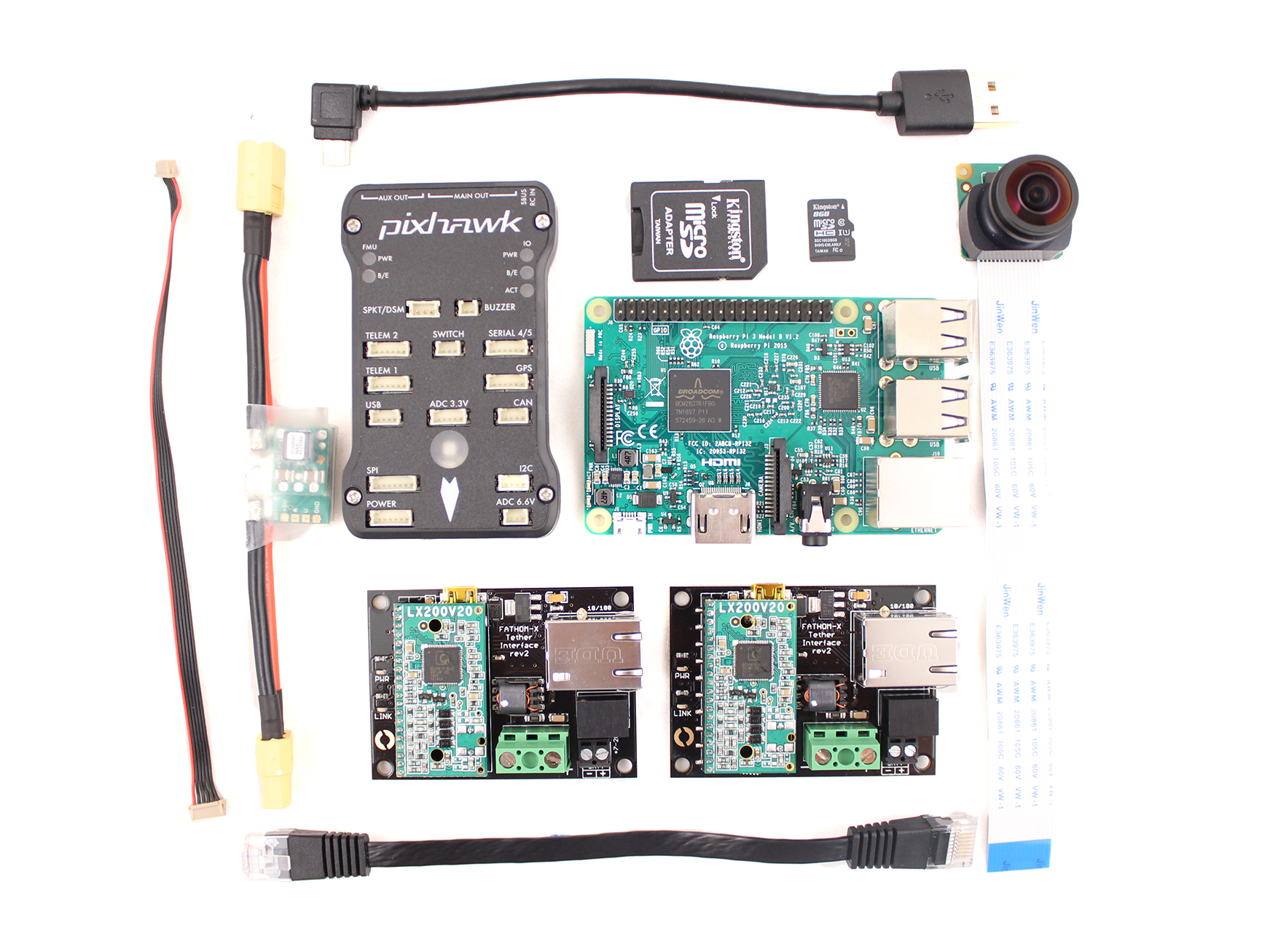

I was wondering if anyone was using this electronics package ?
https://www.bluerobotics.com/store/elec ... rdusub-r1/
Comes with a HD lowlight camera and control boards, all the coding is done and you can configure it to suit your ROV.

So I didn't purchase this as a package but did end up assembling it piecemeal over time. There are a lot of positives from it, but it isn't cheap, though not unreasonable for what you get. The question comes down to whether it's overkill for your application or not.
Pros
Pixhawk adds a lot of controllability - ROV drives like it's on rails
Fathom-X boards can communicate over only two wires - tether can be very small
Lots of flexibility within the configuration and more being added on a regular basis
