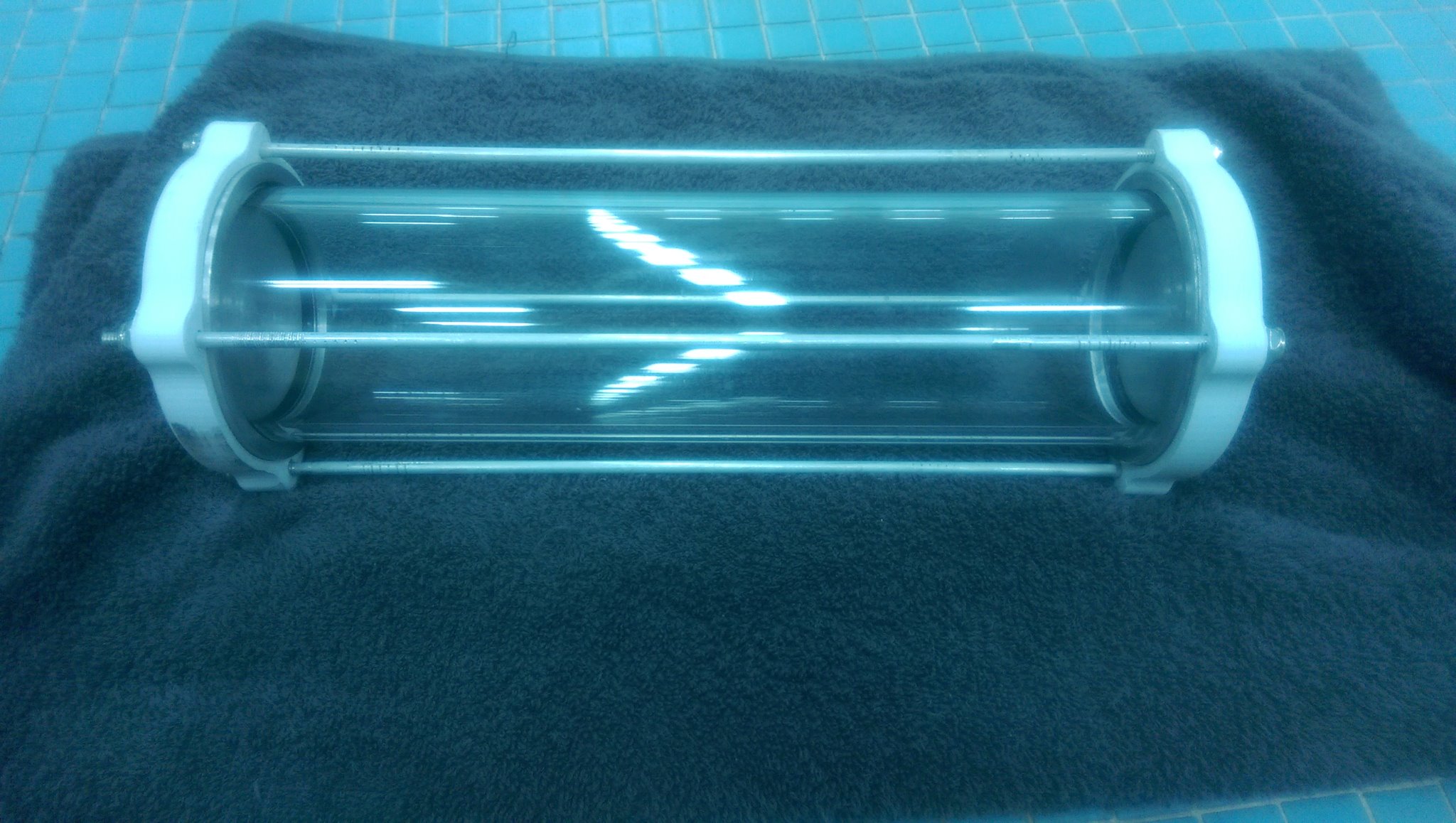

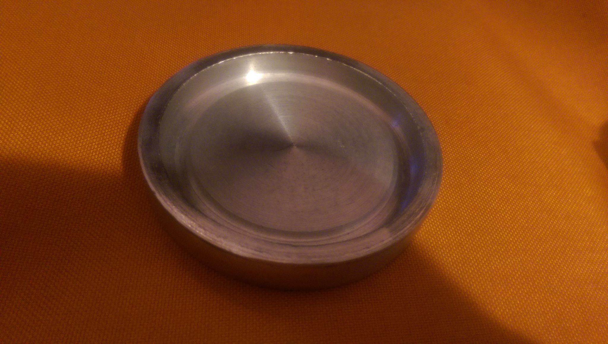

I've been working on building a hull for my electronics. This is my 3rd iteration, and the one I'm most confident about. I'm working on the primary housing --housing my camera, batteries, and Arduino-- and so far it looked like it was going pretty well.
It's primarily made out of a 3" (76.2mm) ID 3.5" (88.9mm) OD acrylic tube. The ends are machined aluminum with 2 3" (76.2mm) ID 3.5" (88.9mm) OD o-rings, one on each end. The white brackets on the ends serve only to hold the end caps in place by means of four threaded rods. I tested it in my bathtub just to make sure the idea wasn't fundamentally flawed and that worked really well, actually. I took a trip to the pool at my university and threw it in the deep end and I'd say it lasted 6' (1.8m) before it started leaking.
I feel pretty stumped as to where to go from here. Any input would be greatly appreciated!

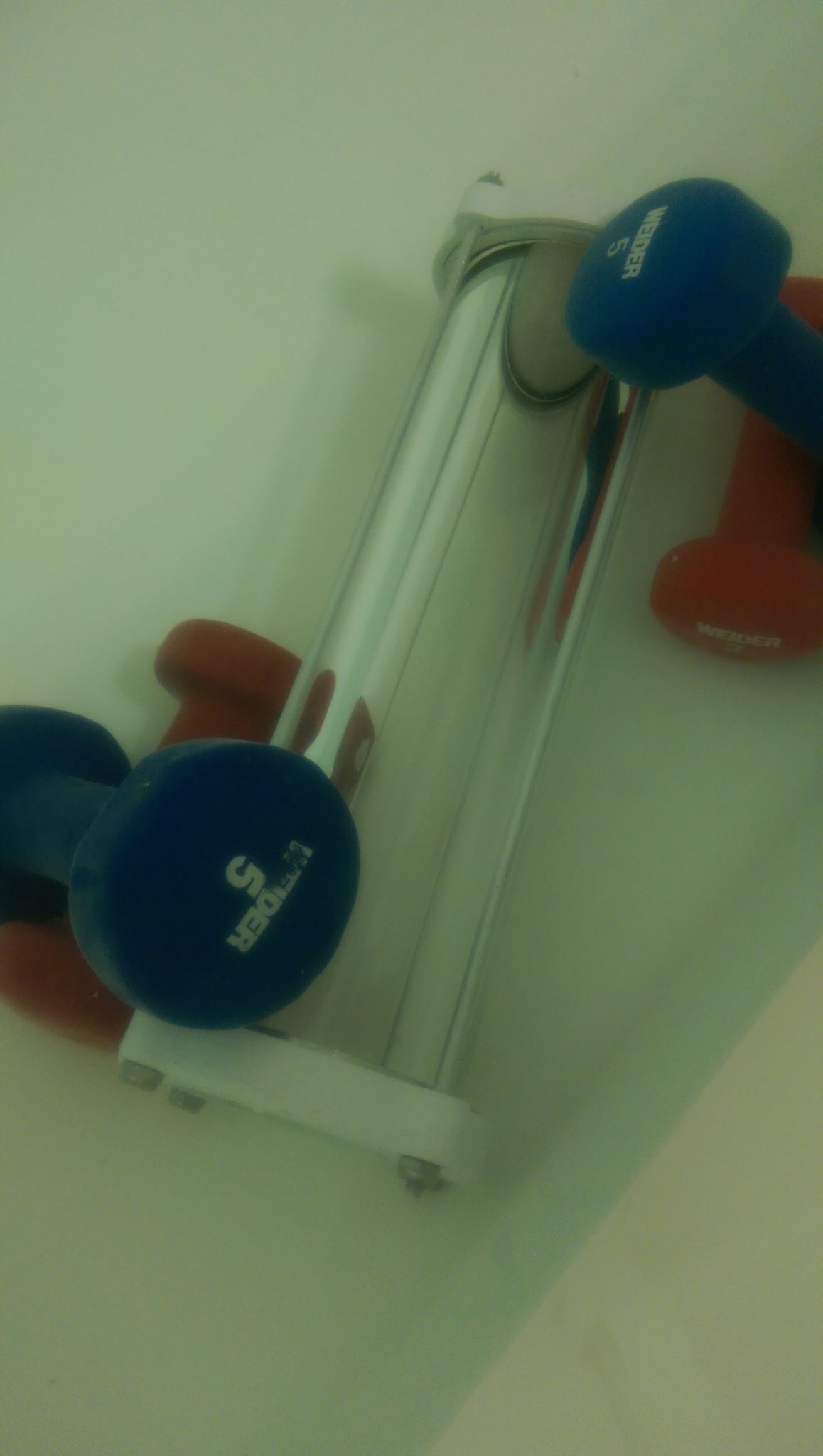

- Bathtub test, looking good!
- 12788342_928970393817015_1550511540_o.jpg (90.9 KiB) Viewed 12856 times

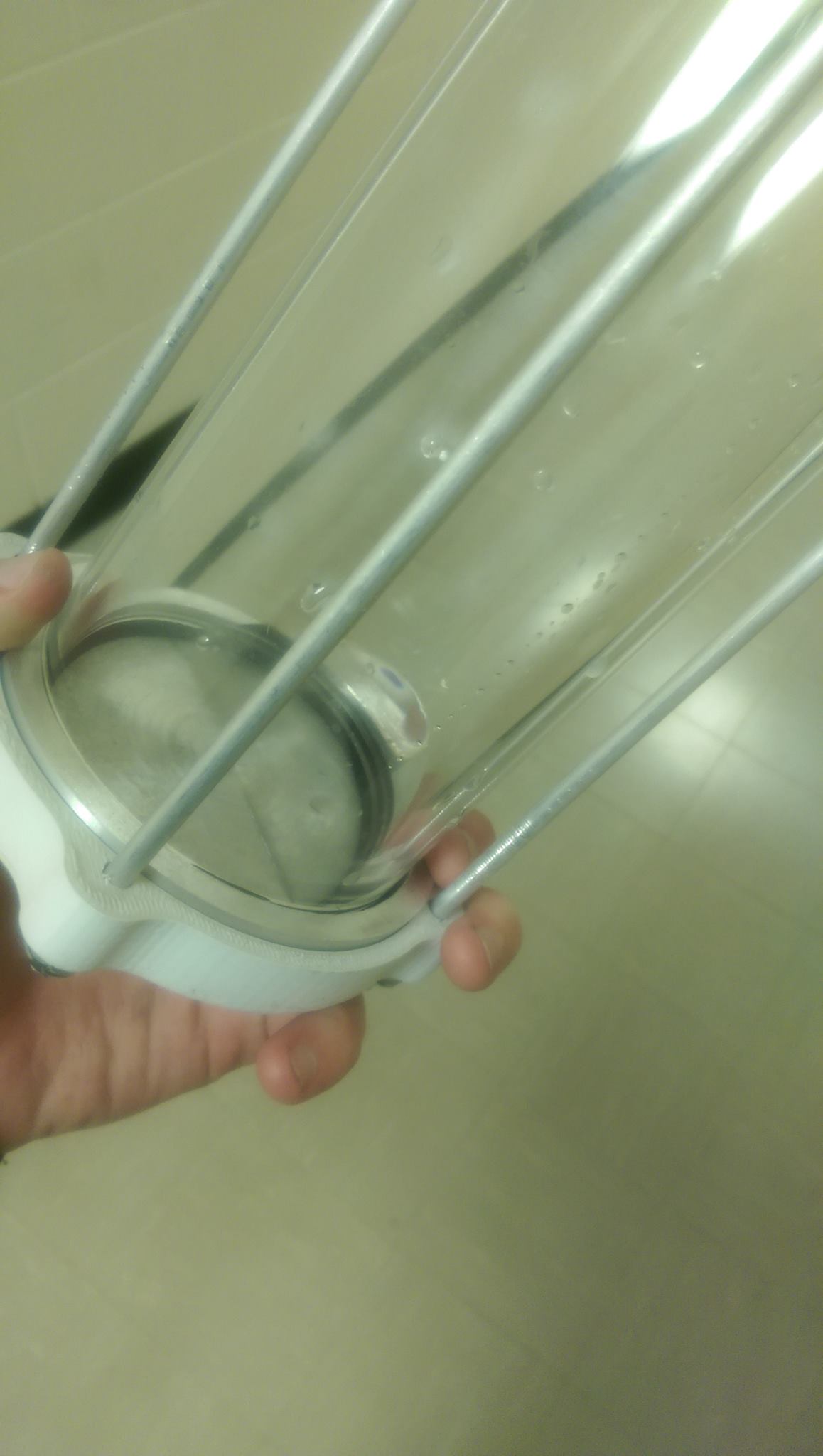

- 12' (3.6m) depth test, not so good.

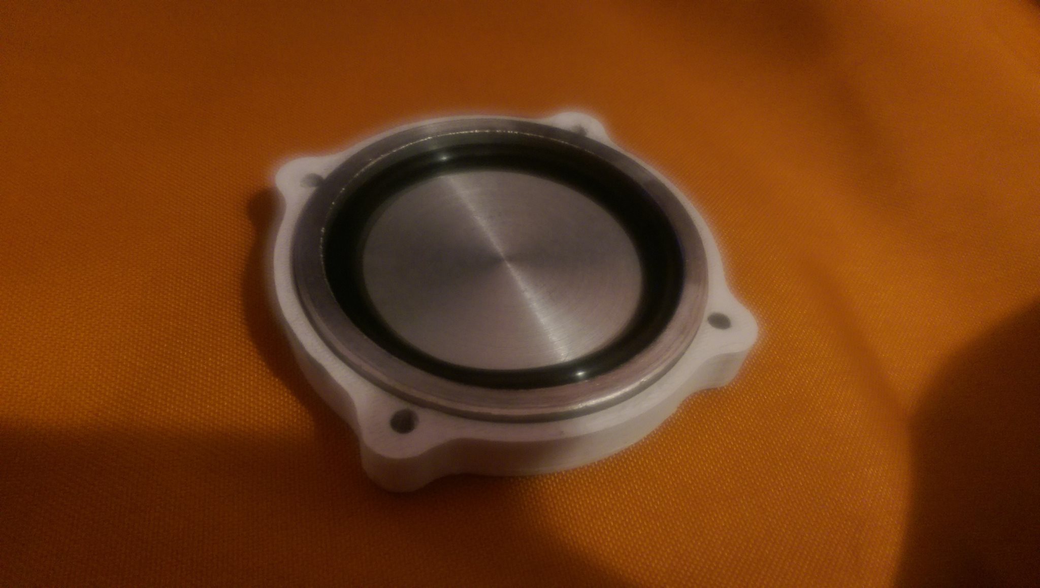

- Complete end assembly. Aluminum cap + bracket + o-ring
- 12755166_928987603815294_1969675707_o.jpg (218.42 KiB) Viewed 12856 times
- The aluminum cap
- 12787081_928987593815295_494889958_o.jpg (284.29 KiB) Viewed 12856 times

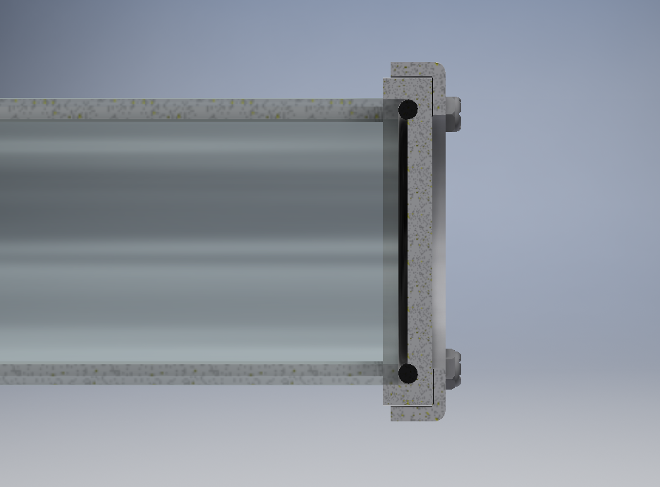

I'm adding a CAD drawing that might help clarify what how the tube end works
- Untitled.png (347.37 KiB) Viewed 12853 times

Re: Acrylic/aluminum hull problems

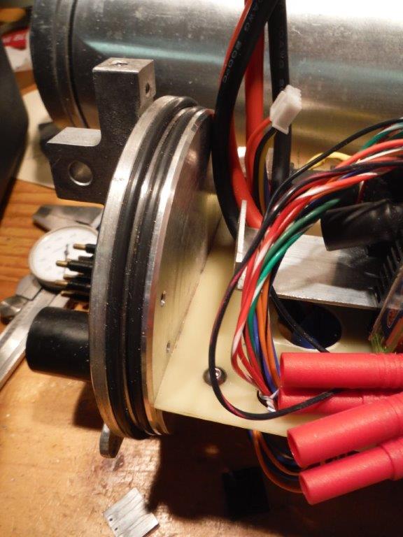

You also shouldn't need to get it that tight. You definitely need to use some grease. I use vasoline. Just a little to moisten the o-ring. You have to keep the area very clean also. I think if you had a part of the end cap that extended into the tube that would work better. I have double O-rings on my setup. One with a seal inside the tube and one seals on the end of the tube. You have to think where is the o-ring going to go when water pressure is squeezing it? I think yours would likely get pushed inside with your current design if you take it too deep.
Home Depot should have threaded rod. You could also get unthreaded and use a die to thread just the ends which would be stronger. You can also order it from Mcmastercarr.com or onlinemetals.com
I was thinking the easiest thing to do would be to re-machine the aluminum caps with a taller center piece, or deeper o-ring grooves. Is there any advantage to the double o-ring system other than redundancy?
Here is how my end cap seals: This works for me, I have never had an issue with this design.
I think your rods would be fine but I would use SS or Brass. You could thread just the ends of solid rod.
