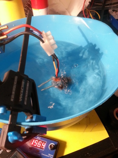

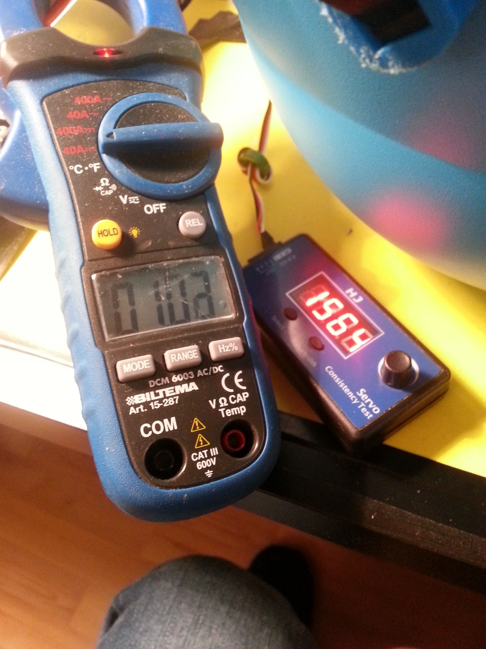

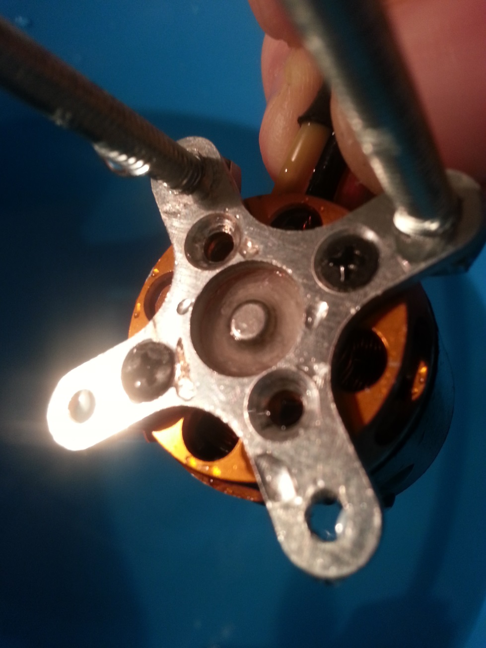

I have some Igus composite bushings I want to test some day. I believe they are the same type as is used in the Bluerobotics thrusters.
Designed to work in submerged environments. Only problem was that the exact size I needed for my motors didn't exist so I have to file them down from 5 to 3mm if I want to use them. Both inner and outer diameter fits perfect.
If anyone wants to try them I would suggest looking at the Igus websites and sending them an email.
I got 5 of each size for free as a test
I was quoted a price of $5 pr piece if I were to buy more.
Also. I am currently testing a "why the hell not" idea I had.
I have printed bushings using Taulman 910 nylon 3d printer filament. I just wanted to see if they would hold up at all.
So far they have only been running in water for 5 hours while monitoring RPM, amp draw and noise and so fare they show no sign of wear at all. The amp draw decreased as they wore in and has stayed the same after that.
While they run in water there is no noticeable heat generated. But while running them dry at max rpm for somewhere between 30 and 60 seconds they started getting slightly warm.
However, even Bluerobotics does not recommend running their thrusters dry for more then a short while.
I will improve my test setup, put a prop on it an lett in run for a few days or until they brake. Because why the hell not?

Ran the motor for another 2 hours yesteday with no change. Still runs fine and no noticeable wear, friction or noise change.
The nylon will absorb moisture and swell for sure but I'm not sure how big the effect will be. So I have the motor sitting in water now to see if it there is any notable difference in friction after one day in water.
I do believe the Bluerobotics thrusters are encased in some sort of epoxy to protect the winding of the motor. I plan on doing the same, but I'm not sure exactly what epoxy to use yet.
