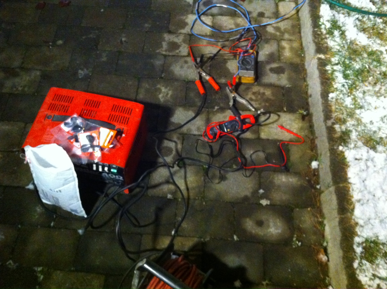

Have done som testing with Rule 1100 and Graupner propellers that may be of interest for others.
Used a car start buster to get a stabil and strong supply for the test.
Test setup
bilde 1.JPG (533.31 KiB) Viewed 5767 times
bilde 2.JPG (436.19 KiB) Viewed 5767 times
bilde 3.JPG (453.29 KiB) Viewed 5767 times

How did you calculate the force?
Re: Result from testing of Rule 1100 with graupner propeller
Posted: Dec 5th, 2012, 5:07 am
by fluxno
onibnasir wrote:How did you calculate the force?
its measured with a weight. you see it on the second picture, just below the headligth of the car.
he's using the same principle as in this guide: http://www.homebuiltrovs.com/howtotethe ... edrop.html

Hi Kjetil,
I presume you took into account the ratio between the pivot point, the point you're measuring the force and the point the bilge pump is acting on, it looks about 2 to 1 from the pictures, but it isn't too easy to see.

by Kjetil
I did calculate out the correct force, I do not remember the ratio at the moment. It was more that 2 to 1.
