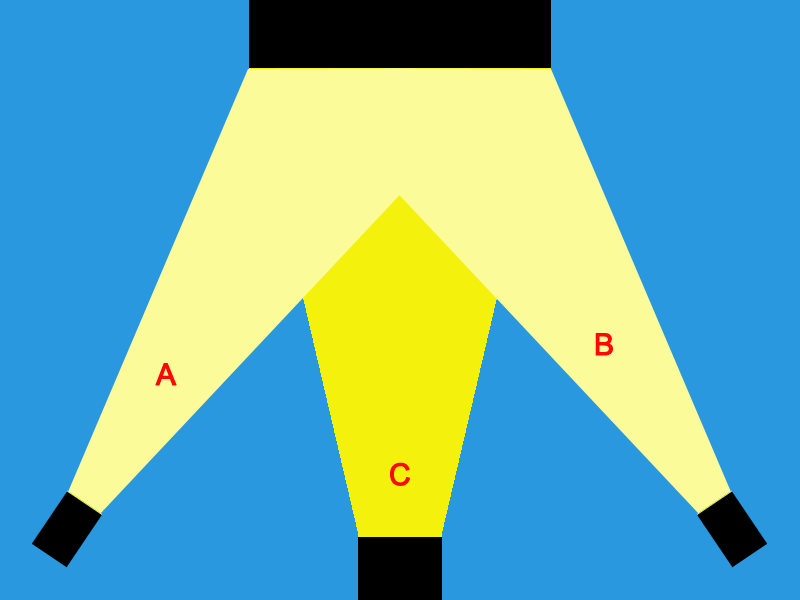

Also very important for filming under water is backscatter, this is the reflection of light on particles floating in the water.
To minimize this backscatter its important to place you lamps so that the reflecting light can't reach the lens of the camera.

My understanding (and I accept that I might be wrong) is that in general the light source should be placed behind the camera and to avoid backscatter, situated a suitable distance apart to each side. As shown – Dscent303.

http://www.uwphotographyguide.com/backs ... underwater
Place 2 lights left and right from the camera and use narrow beam lights so that particles in the water don't get illuminated.
In the picture section A and B are the lights and in these lightbeams backscatter can occure.
In section C there is no light so particles in the water will not produce backscatter.
