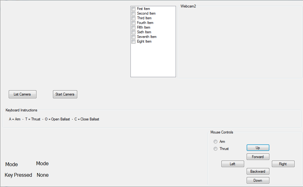

Sneak peak at the GUI. CAD drawing and electronic ideas to come soon.
GUI of my ROV.
GUI of my ROV.

Running C on the Arduino, the actual Arduino code is very simple, and all it does it write values to pins, and reads the pins and sends them back to the GUI, which is written in a mix of VB and C#. The GUI is a little more complicated because there was so many things to do. First we made a nice interface, then we made controls for the thrusters with keyboard and mouse controls, using the arrow keys to go forward, backwards, turn left, and turn right. For altitude, to go up we used page up and to go down we used page down. We also made a speed control, ranging from 1 to 5, 1 being the slowest and 5 being the fastest. Once we got to coding arm control we got stuck so we decided to make 2 modes, thrust mode and arm mode. In thrust mode you cannot operate the arm, and all functions for the thrusters apply. In arm mode, the thrusters switch to "maintain" in where they maintain the position of the ROV while the user uses the arm, using the arrow keys. While in maintain mode though, using the arm could move the ROV unintentionally, so we used a gyroscope sensor to sense and record any movements. The code will then interpret the data and tell the ROV to move back to its original position. The last part of the software was importing webcam feed, which was really easy and simple, it just imports the feed and displays it.
