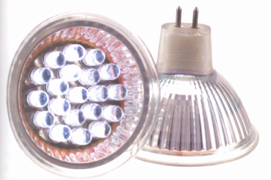

Yeah Steve I remember the testing that you did a while back with the LED's, I just may stick with good ol halogen, but I just don't know. These are the bulbs I was thinking about, but with highest lumen output I can find.
- LED-MR16-NEW-Large.gif (54.84 KiB) Viewed 18885 times
Re: LED's
I like those, I wouldn't even have to change housings to give those a try. I'm going to look into finding a few of those to test out.

Re: LED's
Hey guys,
The LED MR 16 style bulbs from allelectronics.com seem really good, 175 lumens for .4 amps (1/4 of the draw of a halogen MR 16 means less voltage drop) for 8 dollars.
http://www.allelectronics.com/make-a-st ... .NW/1.html
Another good option seems to be the 10mm led from electronics goldmine. If it really is 265,000mcd it converts to 100 lumens for .1 amps but this seems way to bright for that style led. I envision on of these in each corner of the frame for a seafox style rov giving 400 lumens for .4 amps.
http://www.goldmine-elec-products.com/p ... ber=G16642
There are many options here but these seem like the most light for the least current
