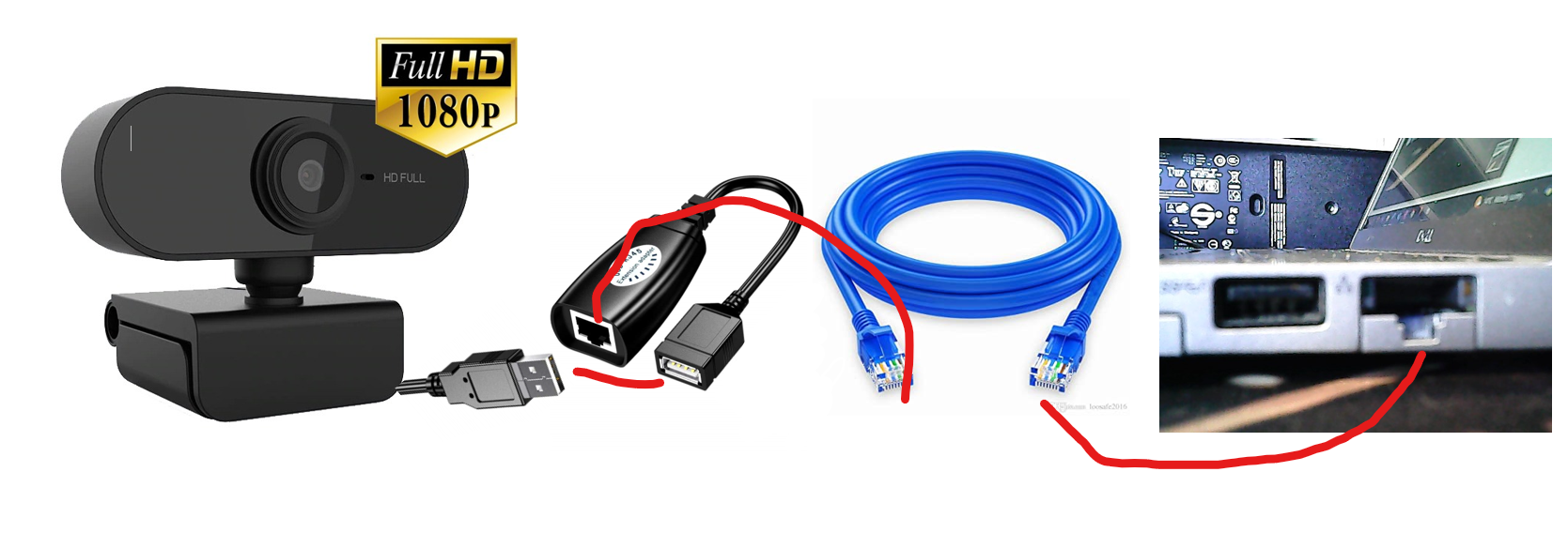

kinda was thinking doing this would it work???? seems to be the cheapest and the easiest to do.
Re: 100ft/30m underwater camera
Posted: Aug 2nd, 2022, 2:12 am
by JonnoLad
From what I can see that should work, just bear in mind that you will need to use another rj45 - USB adapter on the laptop end, so it will be plugged into the USB port on the laptop, not the rj45 port. Otherwise there will be no 5v power supply to the camera. It looks like those rj45 adapters often come in pairs of a male and female USB version, so that should be easy to do.

all right kool thanks, thanks for the help now my rov will be able to see underwater 8-) 8-) 8-) 8-)

best to make sure you can power the Camera end so less problems. I used this on a 100' Cat5e cable with good results.
