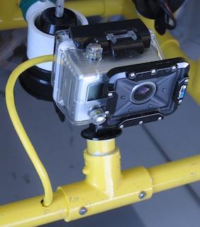

If you are looking to modify the existing case... i have seen a few examples of where they take the backpack door, and mounted a grommet in that. This allowed the 30pin connector to be connected, and extended outside the case to the control system.
Here is an example:
https://csumb.edu/eel/camera-system
breakout board in backpack space
gopro wetmount.jpg (95.77 KiB) Viewed 50142 times
Final assembly!
Final assembly!
gopro wetmount2.jpg (15.6 KiB) Viewed 50142 times
Not my work personally... but I am a BIG fan of the idea!
