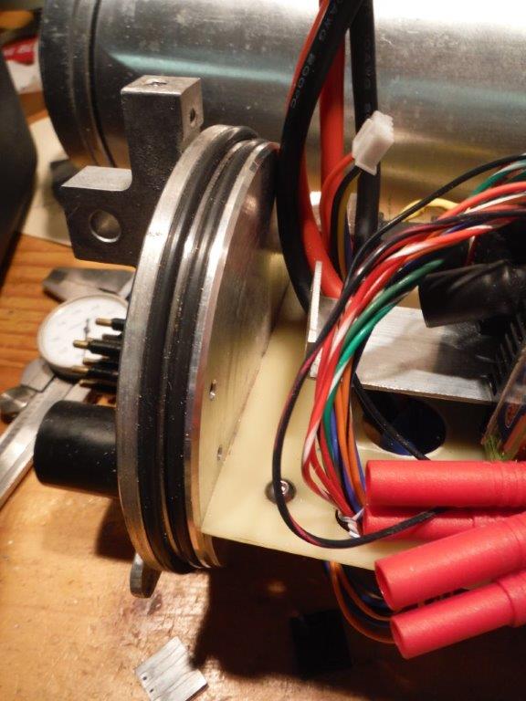

by TigerShark
Here is how my end cap seals:
This works for me, I have never had an issue with this design.
I think your rods would be fine but I would use SS or Brass. You could thread just the ends of solid rod.
