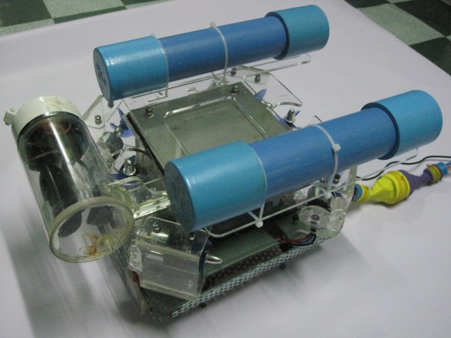

The size of my ROV is around 1 feet squared and weight is around 3 kg.
We used four horizontal thrusters but the motors turn only half speed when moving forward. When moving 45 deg to forward, two diagonal motors turn at full speed.
The thruster assembly provides more than enough thrust for my ROV. The max speed is around 1 m/s!
The thrust won't be a problem unless you have a very big and heavy ROV.
If you can see in the photo, our ROV consists of two stainless steel plates which sandwich the control box. They are used as heat sinks.
The only glitch with the thruster assembly is the propellers produce less thrust in reverse than in forward.

WOW, thanks for the post. I wish there was a 'yearbook' kind of thing for everyone's ROV with a brief write-up or link to more info. I've never seen one quite like this. I have been thinking about doing some kind of thru-hull thing and using it as a heat sink with a pass-through for the heat-generating items like lights, motors and whatnot.
This setup addresses that really well. COOL! (also thanks for the info on the amount of thrust required for a small class ROV). I had started another thread about the different power requirements for different sized (weighted) ROVs and it didn't really go anywhere. Good to see that a small unit like this is amply supplied by small motors.

The problem with a small rov is the cable is large relative to the ROV and so the stiffness of the cable has considerable effect on the movement and the maneuverability of the vehicle. You should address that in your ROV.
You guys motivate me to produce my "yearbook" of the ROV. I'll post it ASAP.
