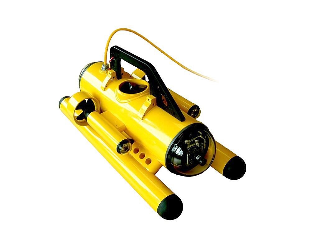

The design is inspired from subsea-tech mini rov

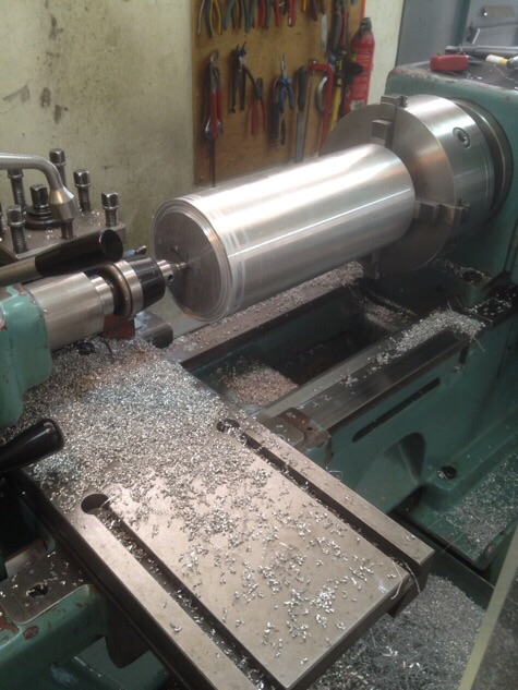

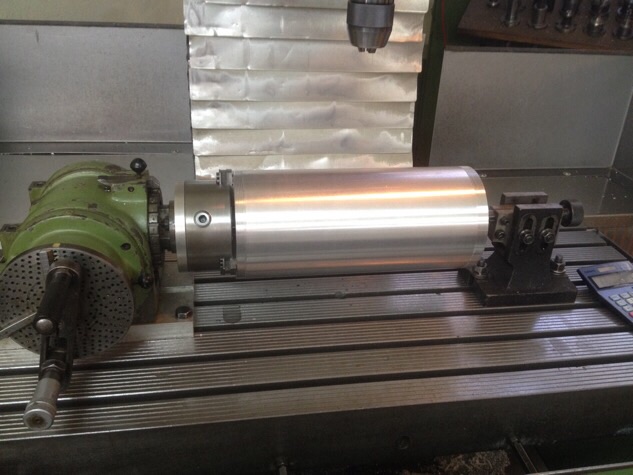

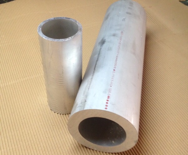

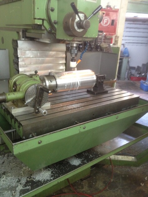

The hull is made from aluminium tube 6061 T6 with 4 mm wall thickness after working with lathe for hours
Ready to drill the hole for ascent-descent thruster

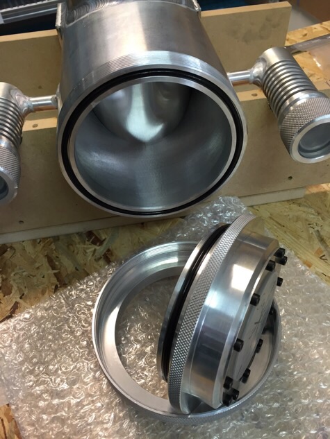

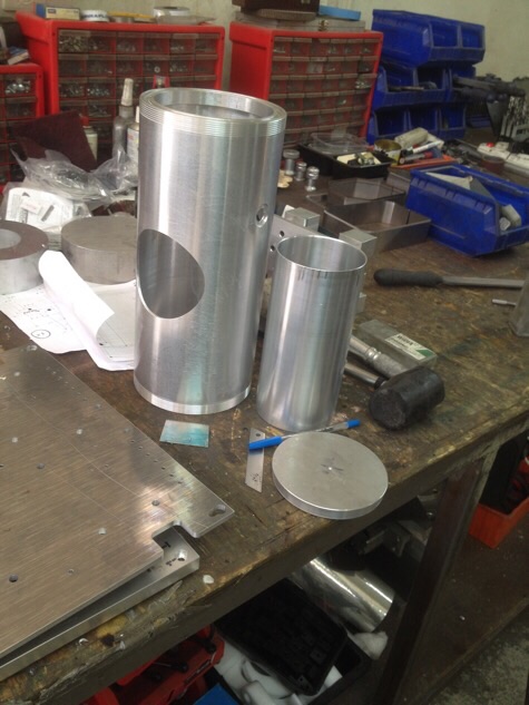

And these are the hull parts ready for welding

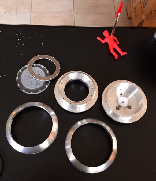

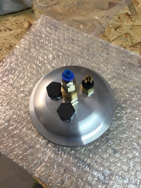

And the endcaps are finished too

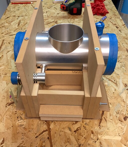

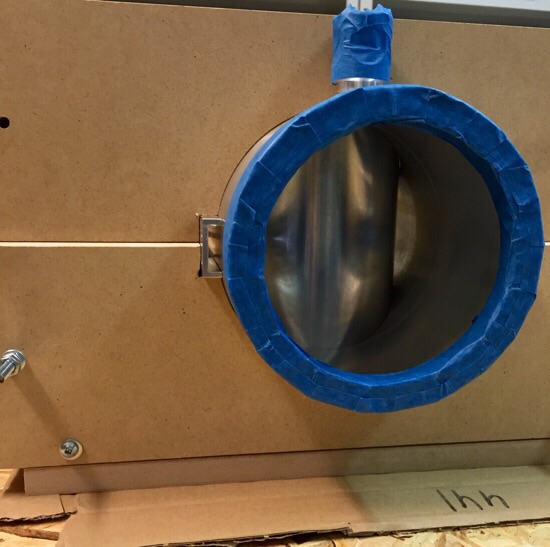

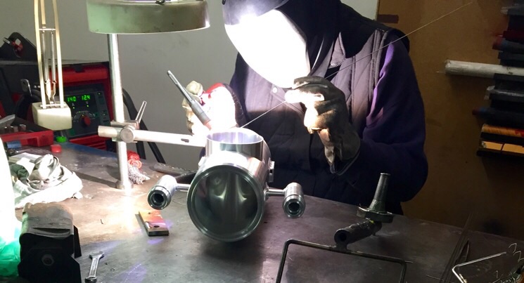

I made a wooden support frame for all pieces to stay aligned for welding and protect the oring grooves with tape

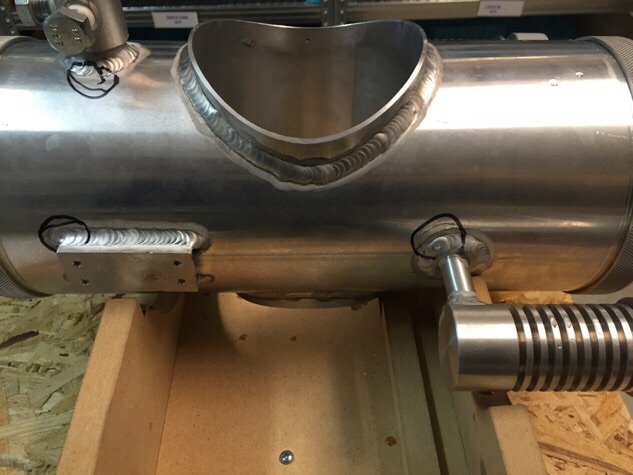

And finally the big time :D

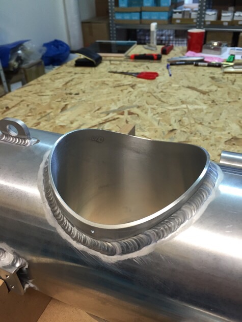

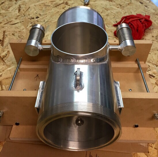

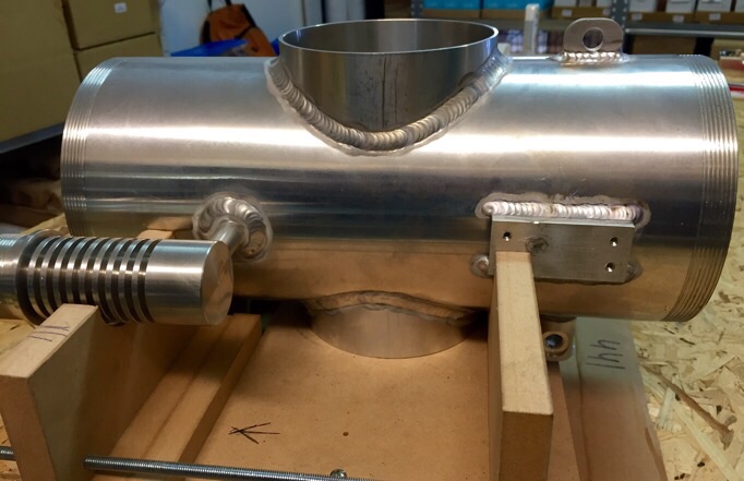

And it's done
Next thing was to trim the vertical cylinder a bit

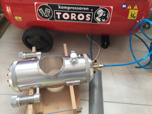

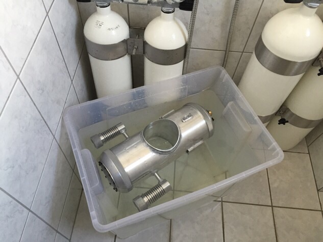

Next thing is to pressure test weddings and check for any leaks.
I assembled endcaps and fit them to the main hull and fill the hull with compressed air up to 5bar
And the moment of truth
Re: DROV-bubbles rov
Posted: Jan 30th, 2015, 9:26 am
by Bubbles
And after an hour playing and checking for leaks I noticed tiny bubbles at three different places
:oops:
S.....t I have to fix the leaks
