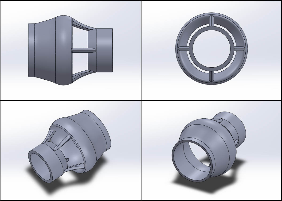

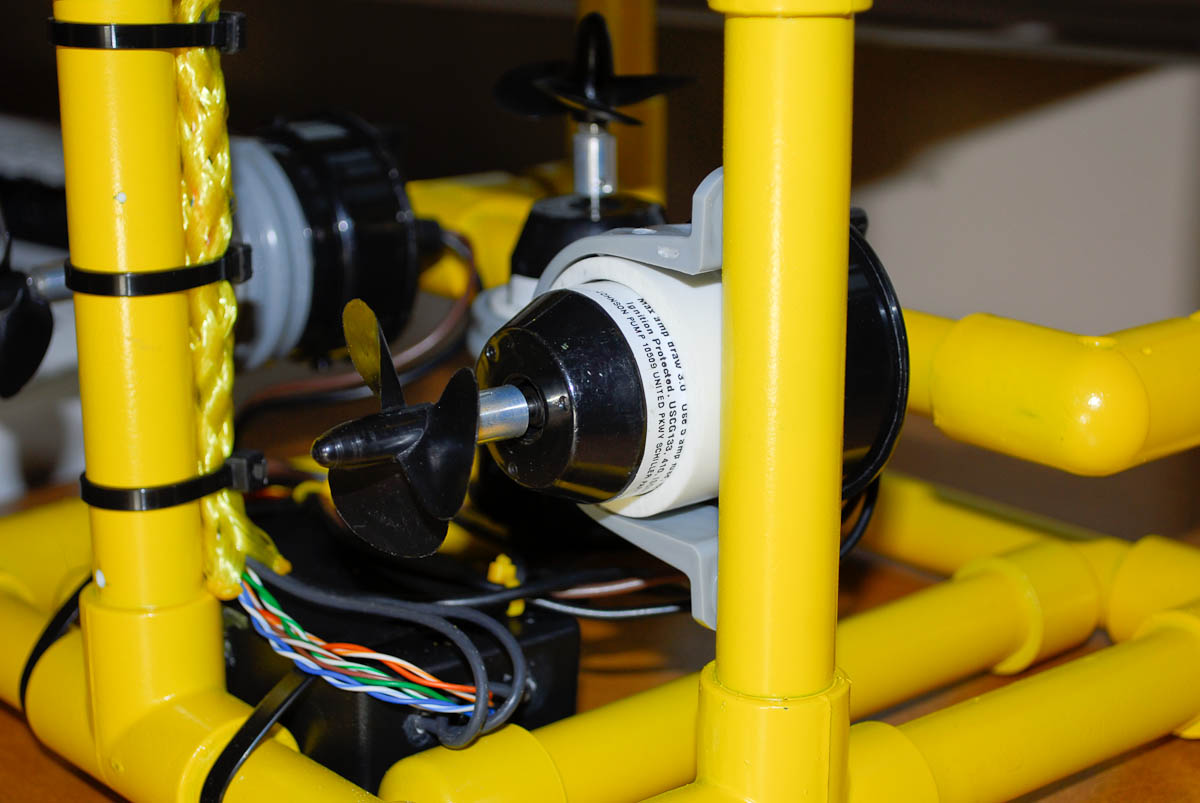

This is another project I have been playing around with again too. I tried making a few Kort nozzles back in the day out of PVC and while none of them gave me more thrust I did have a little luck with one that actually dropped the amps draw during one test. This is going to be designed around the Mairfair 750 GPH bigle pump thruster that I normal test although it could be easily changed to fit other pumps I think.
... and this my first design I'm about to print out. If it works out I might incorporate the mount right into the nozzle design too.

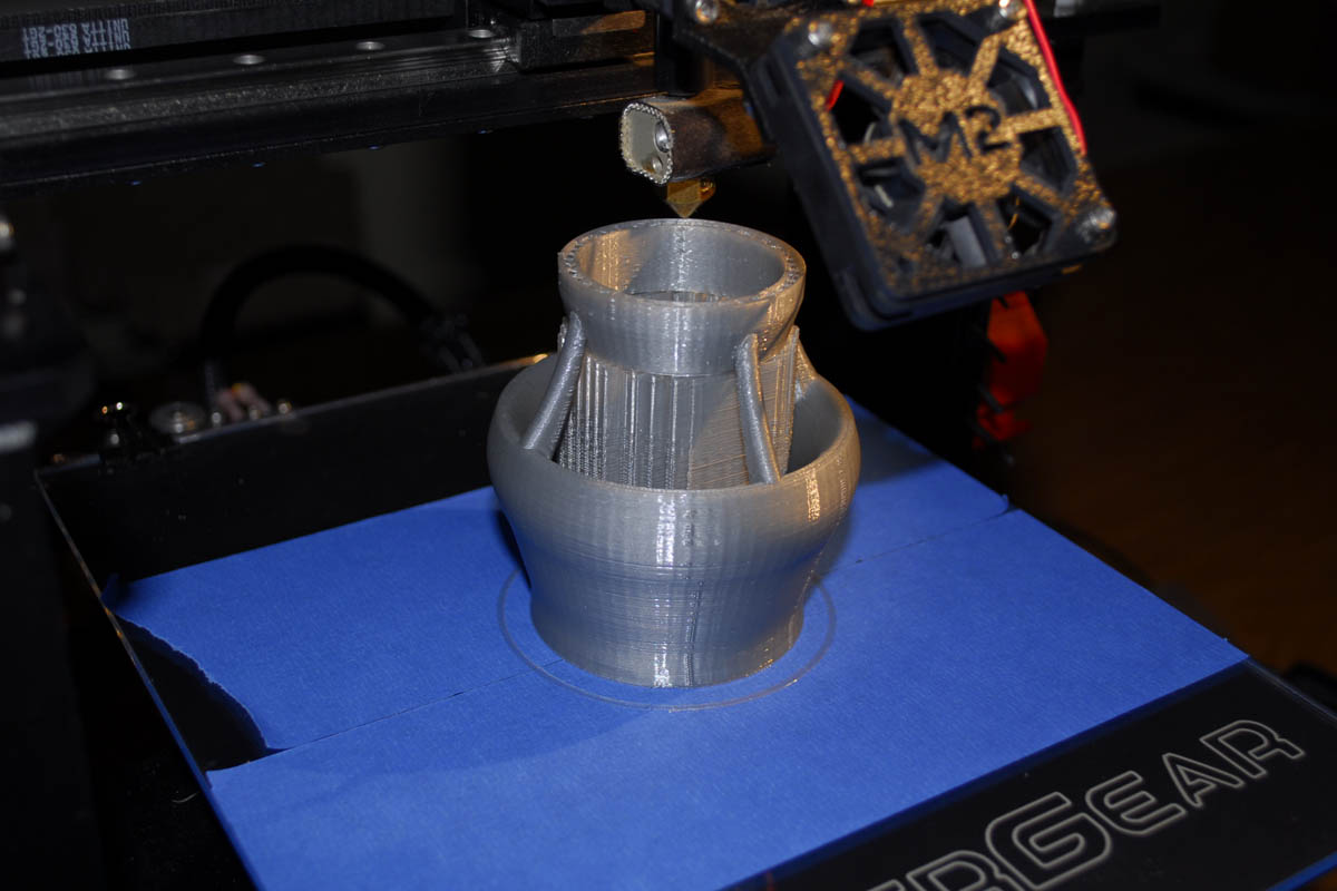

Here it is in the process of being printed....

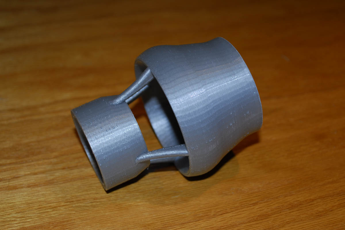

...and after about 2.5 hours here is the finished product. It's a little rough as I printed it on a fast setting and low infill just to see if it actually fits.
Unfortunately my dimensions where a little too tight and it was weak with the low infill so I broke the support arms trying to force it on to the pump. :oops: :cry: I changed a few things and printed another one but it was late by the time it finished so I didn't get to try the fit on that one yet. Hopefully tonight I'll have a little time to try it.
